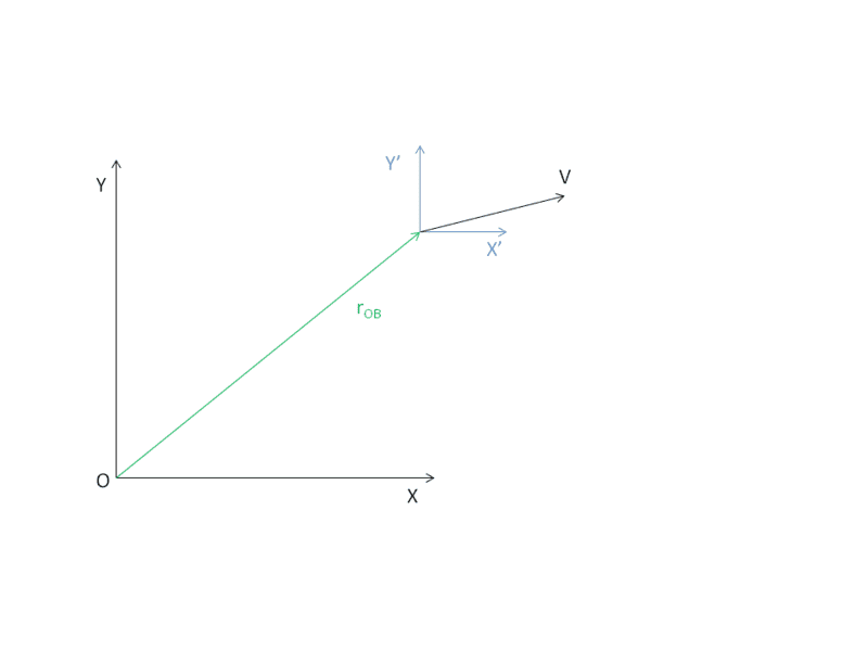

Ultimately, I want to relate the angular momentum to the sum of the torques. Towards that end we have to discuss semantics a little bit. We need to be careful a a vector viewed from and defined in. I drew up a simple schematic for discussion purposes. Consider the point A, mass m, translates due to external forces with V=V(t) and a=a(t). X'Y' remains coincident with point A throughout.
If you considered the basic kinematic equations
[itex]\frac{\text{d}}{\text{dt}} P|_{XY}=\sum{Forces}=\frac{\text{d}}{\text{dt}}P|_{X'Y'}+\omega \times P|_{X'Y'}[/itex]
where [itex]\omega[/itex] would be the rotation of the X'Y' with respect to the inertial frame.
If I understand your previous post, to define [itex]P_{X'Y'}[/itex] we'd consider the momentum of the particle, defined in the X'Y' frame. Since the frame is coincident with the particle at all times the velocity of the particle, defined in the X'Y' frame, is zero and therefore [itex]P_{X'Y'}=0 \implies \frac{\text{d}}{\text{dt}} P|_{XY}=0 \neq ma[/itex].
However, what I'm saying is that [itex]P_{X'Y'}[/itex] is the momentum vector, defined in the XY frame, as viewed from the X'Y' frame. This would give, in this case, [itex]P_{X'Y'}=V\cos{\theta}\hat{i}'+V\sin{\theta}\hat{j}'[/itex].
Applying the same to the example you gave, I agree that the angular momentum defined in the co-rotating frame would be zero. However, if we're going to consider the sum of the torques on a body in the co-rotating frame, then the angular momentum, viewed in the co-rotating frame, would not be zero.
I provided a bit more rigor in this post (I initially had the same thoughts you presented):
https://www.physicsforums.com/showthread.php?p=3971049#post3971049
Newton's Laws seem to cause me trouble to no end!
