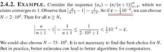

Textbook example proving the sequence n/(n+1) converges to 1, choosing N = 2·10^k when ε = (1/2)10^-k, with the inequality chain shown ending in less than ε.
But I think the definition is as follows:
Let an be a sequence of real numbers. Then an->a iff
for ALL ε>0, there exists an integer N such that n≥N => |an - a|< ε.
The definition says that it has to be true for ALL ε>0, but in the example above, they just let ε to be a rational number with a very specific form. To me, the proof looks incomplete. They only proved the statement for the case of ε being rational number with that very specific form, but how about the case when we're given an irrational ε, or other rational ε that cannot be expressed in that specific form?
Is the proof correct or not?

Well I'm assuming k is a real number, in which case there is nothing wrong with the proof (verify this on your own). However, there is a much simpler estimate that could have been made, namely
[tex]\frac{1}{n+1} \leq \frac{1}{N+1} < \varepsilon[/tex]
provided that [itex]N > \frac{1}{\varepsilon}-1.[/itex]
Out of curiosity, which text are you learning from?

I looked at my book again and the context before the example highly suggests that k is a natural number (or 0). It says "it suffices to consider only values for ε of the form (1/2)10-k...agree with L to at least k decimals of accuracy."
If this is the case, is the proof still correct? If so, why?
(I understand your much simpler proof, but I just want to know whether "the proof provided above" is complete or not.)
The book from which this example is taken is Real Analysis by Donsig.
Ah OK, well the author is choosing not to consider all real epsilon, which is weird. I would say it doesn't matter much since if we let epsilon -> 0 we can still make our sequence arbitrarily close to 1. Anyways it seems simpler to consider all real values of epsilon (> 0) and replace [itex]\frac{1}{2}10^{-k} = \varepsilon[/itex] with [itex]\frac{1}{2}10^{-k} < \varepsilon.[/itex]

Given any [itex]\epsilon> 0[/itex], there exist k such that [itex](1/2)10^{-k}< \epsilon[/itex]. Then if [itex]|a_n- L|< (1/2)10^{-k}[/itex], it is less than [itex]\epsilon[/itex] so this is sufficient.
