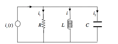

Hi there guys I am new to this forum and i have a problem with a bit of cw. It's regarding an RLC circuit. I've come up with a picture (attached) that denotes the equation.
I know the equation is L C \frac{d^2 i}{d t^2} + \frac{L}{R} \frac{di}{dt} + i =i_s (t) , t≥<br /> 0
I do not really know where to start to show that, I've been given the equation and i was able to draw out the circuit but from there I do not really know where to go as I do not know physics of a circuit very well

no I'm able to solve the equation, it's just that I'm ahving difficulty showing that the equation equals what i have given
Start with
\displaystyle i_s(t)=i_1(t)+i(t)+i_2(t)\ .​
This comes from applying Kirchhoff's Current Law.
Then since the inductor, the resistor and the capacitor are all in parallel, the instantaneous voltage across anyone of these devices is equal to the instantaneous voltage across any other one of these devices.
I think i may have got it? here is what i have
Current through resistor: \frac{1}{R}
Current through inductor: \frac{1}{L} \int i\,dt
Current through Capacitor: C\frac{dv}{dt}
Applying kirchhoffs law i got
\frac{1}{R} + \frac{1}{L} \int i\,dt + C\frac{dv}{dt} = 0
Differentiating wrt t i got
\frac{1}{R} \frac{di}{dt} + \frac{i}{L} + C \frac{d^2 i}{dt^2} = 0
Rearranging to get the equation
LC \frac{d^2 i}{dt^2} + \frac{L}{R} \frac{di}{dt} + i = i_s (t)
I'm pretty sure i missed something here, anyone ought to help me out?

Some of your expressions are not quite right.
Let \displaystyle \ v(t)\ be the instantaneous voltage across each component.
For the resistor, \displaystyle \ v(t)=i_1 R\ .\ \ Notice that in the figure, the current through R is labeled, i1 .
For the inductor, \displaystyle \ v(t)=L\frac{di}{dt}\ .\ \
For the capacitor, \displaystyle \ i_2=C\frac{dv}{dt}\ .\ \
Use these to find how i, i1, and i2 are related.
okay i got i_1 + i_2 + i = i_s (t)
using the equalities v = iR = L\frac{di}{dt} = \frac{Q}{C}
I got i_1 R = L \frac{di}{dt} → i_1 = \frac{L}{R}\frac{di}{dt}
not too sure how to transform C\frac{dv}{dt} → LC\frac{d^2 i}{dt^2}
Use \displaystyle \ v(t)=L\frac{di}{dt}\ \ to find the derivative of \displaystyle \ v(t)\ .\ \
Then plug that into \displaystyle \ i_2=C\frac{dv}{dt}\ .\ \
