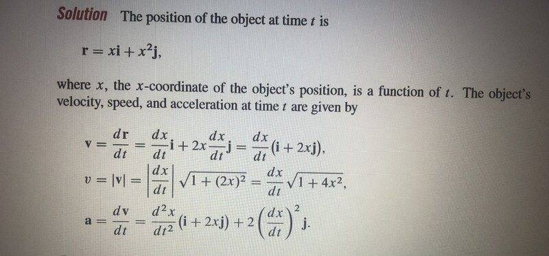

Not sure on last step.
I need a little guidance on how they got the last step to derive acceleration, I can follow up till there. Any help would be greatly appreciated as I find it hard to move on unless I have understood.
##v=\dfrac{dx}{dt}(i + 2xj)## and ##a=\dfrac{dv}{dt}.## So
\begin{align*}
a&\stackrel{def}{=}\dfrac{d}{dt}\left(\dfrac{dx}{dt}\cdot (i + 2xj)\right)\\
&\stackrel{\text{product rule}}{=}\dfrac{d^2}{dt^2}x \cdot (i + 2xj) + \dfrac{dx}{dt} \dfrac{d}{dt}(i + 2xj)\\
&=\dfrac{d^2}{dt^2}x \cdot (i + 2xj) + \dfrac{dx}{dt}\cdot\underbrace{\dfrac{d}{dt} i}_{=0}+\dfrac{dx}{dt}\cdot 2j\cdot \dfrac{d}{dt}x\\
&=\dfrac{d^2}{dt^2}x \cdot (i + 2xj) + 2j\left(\dfrac{dx}{dt}\right)^2
\end{align*}

You legend! I know it might be pretty obvious to some but it really can’t be difficult for a textbook to show a few more steps, for slower people like myself. Ron larsons textbook is really good for showing steps I’ve noticed.
Thank you again! I can finally go to bed
