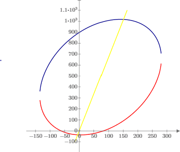

(I attached an image of a plot of the ellipse that needs to be revolved with its axis of revolution represented by a yellow line)

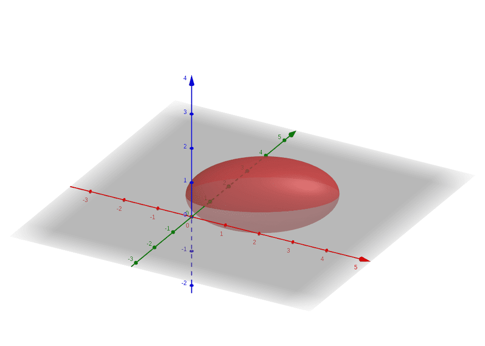

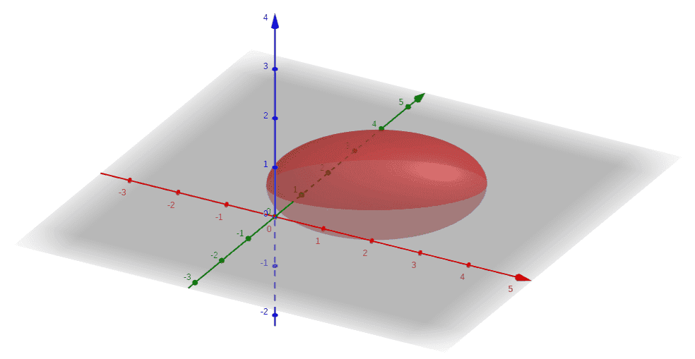

Let's say your ellipse has axes of length ##A## and ##B##, and center ##(h,k)##, and is rotated by angle ##\theta##. This is represented by the equation $$\frac{((x-h)\cos(\theta)+(y-k)\sin(\theta))^2}{A^2}+ \frac{((x-h)\sin(\theta)-(y-k)\cos(\theta))^2}{B^2} =1.$$ If ##A>B## then I suspect the equation you're looking for is
$$\frac{((x-h)\cos(\theta)+(y-k)\sin(\theta))^2}{A^2}+ \frac{((x-h)\sin(\theta)-(y-k)\cos(\theta))^2}{B^2} + \frac{z^2}{B^2}=1,$$
simply tacking on a ##z^2/B^2## term. The denominator is ##B^2## because, since we're revolving around the semi-major axis, the new axis must have the same length as the semi-minor axis. There's none of the extra stuff in the numerator either because those only deal with translations and rotations in the ##xy##-plane. Using a 3D-grapher, it'll look something like this:
(I used ##h=1, k=2, \theta=\pi/6, A=2, B=1##).
I haven't checked your numbers, but unless I misunderstand, your picture can't be correct. A prolate spheroid must be an ellipse rotated about its major axis. Your yellow line apparently doesn't align with the major axis.
