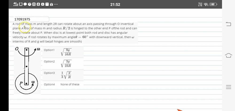

Rod of mass M and length 2R can rotate about an Axis passing through O in vertical plane a disc of mass M and radiusR/2 is hinged to the other end P of the rod and can freely rotate about p when the disc is at the lowest point both rod and disc has angular velocity w if rod rotates by maximum angle 60 degree with downward vertical find w in terms of r and g (all hinges are smooth)
Conservation of energy
