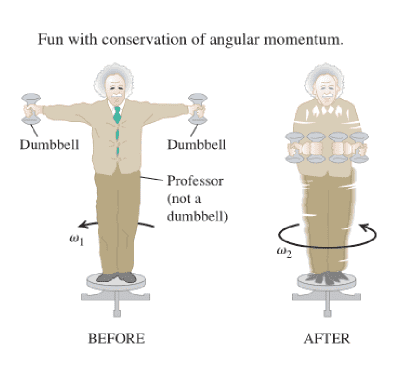

Diagram titled Fun with conservation of angular momentum: a professor holding two dumbbells with arms outstretched, spinning at ω1 on a rotating stand (BEFORE), and with arms pulled in, spinning faster at ω2 (AFTER).
We are aware of the well-known problem of a rotating physicist whose angular velocity ω increases as a consequence of angular momentun conservation (##I_1 \omega_1 = I_2 \omega_2, \Sigma \tau_e = 0##). I am assuming that the net external force (##\Sigma F_e##) is also zero along with the net external torque. However, the net momentum of the physicist (##p=mv##) increases. If indeed there is no net external force on the system, doesn't the increase in the physicist's speed imply a violation of Newton's law for extended objects (##\Sigma F_e = \frac{dp}{dt}##) ?
Why do you say that?

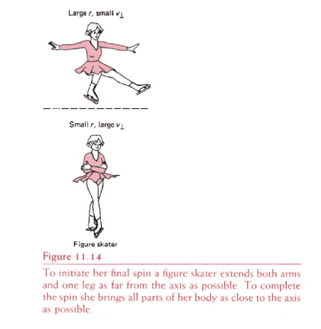

Doesn't the tangential velocity (##v_{\perp}##) increase? You asked a good question and I was wondering too. After all, we know that the (tangential) velocity ##v_{\perp} = \omega r##, so one might argue that ##v_{\perp}## remains the same as the angular velocity (##\omega##)increases and the "radius" (##r##) of the physicist's arms decreases.
Nonetheless, it does look as if the physicist (or a gymast doing figure skating) is indeed moving with higher and higher speeds as his (her) body "radius" goes down.
Let me attach a picture from Arfken's Book (University Physics) where the caption of the diagram he draws makes the increase in the tangential velocity explicit.
Two diagrams of a figure skater in a spin: top labelled Large r, small v-perp with arms and one leg extended outward; bottom labelled Small r, large v-perp with limbs held close to the body. Caption below reads Figure 11.14.

The point is that they are not moving. Or more precisely, their centre of mass is not moving, so ##v=0##. Parts of the body are going faster, but not with respect to the centre of mass. So the angular velocity increases, but not the linear velocity. As you figured out yourself, an external force would be needed for the latter to change. (We are of course neglecting friction at the pivot point which could make an actual skater start moving.)

Some parts of the skater will have an increase in ##v_\perp## without any change in ##r##, for example the shoulders.

Let's focus on the dumbbells. Let's take a simpler system which consists of two rotating dumbbells held to the center by massless rods (or, alternately, "consider a massless professor" [1]). So all the mass is in the dumbbells. Let's start the system rotating with radius ##r_1##.
The moment of inertia of this system is ##2mr_1^2## where ##m## is the mass of one dumbbell. The angular momentum is ##I \omega_1 = 2mr_1^2\omega_1##.
Now pull the dumbbells into radius ##r_2##. The new momentum of inertia is ##2mr_2^2##. Angular momentum is conserved, so ##2mr_1^2\omega_1 = 2mr_2^2\omega_2## or ##(r_1/r_2)^2 = \omega_2/\omega_1##. And ##v_2/v_1 = (r_2\omega_2)/(r_1\omega_1)## ##= r_1/r_2##. The linear velocity is in inverse proportion to the radius.
Note that for the professor with mass, who is carrying some of the moment of inertia, that proportion won't hold. But any way, the linear velocity is definitely not constant. For the massless professor, the dumbbells have higher linear as well as angular velocity.
How can that be? Remember, this is a rotating system. The dumbbell in his right hand is now moving faster. But the dumbbell in his left hand is now moving faster in the opposite direction, at all times. Their total linear momentum at all times is zero, just as it was before.

The net momentum is 0 in both cases. The center of mass is not moving in either case.

The tangential speed does not remain constant. That means that the kinetic energy is increased. The increase in KE is equal to the work done bringing the weights in. Conservation of energy is also separate from conservation of angular momentum and conservation of linear momentum.
