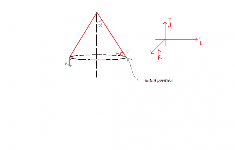

Another question. Will the small weight also descend due to gravity while it is rotating?
If so, will angular momentum still be conserved in such a scenario? I’ve tried looking this up on the internet and not gotten a definitive answer on this.
If it does descend, then the equations will be more complicated, whether or not angular momentum is conserved.
Ahhh, a picture helps. I had imagined the upper puck on a something like an air hockey table. I

I’m informed in the conical pendulum case the total force of the tension force along the string and the gravitational force downwards is horizontal, so absent frictional and air drag forces the pendulum bob will rotate in a horizontal circle. Then your analysis should be valid.
Still, as far as experimental verification because you might need high initial speed of the light weight to get a (near) horizontal initial rotation path, you might want to use an air table for testing it at various speeds with the initial path still being horizontal.
That is nonsense, I am afraid. There is no assurance that the resultant of tension and gravity on the orbitting weight will sum to ##\frac{mv^2}{r}## in the horizontal direction and to zero in the vertical direction. There is also no guarantee that the tension that achieves the requisite balance will match ##Mg##.
If it were so for one case, any modification to the mass of the dangling weight or to the initial velocity of the orbitting weight would make it no longer so.
Right. If you adjust the initial conditions so that ##Mg\cos \phi = \frac{mv^2}{r}## and ##Mg \sin \phi = mg## then the orbit will be circular and stable. But I thought the whole point of the original problem statement was that the dangling weight would descend and produce some interesting dynamic behavior. A stable circular orbit is boring.
The conical pendulum has quite a few degrees of freedom. Even if we discard the current rotation angle, ##\theta##, I count five state variables: ##r##, ##\phi## below the horizontal, ##v_\phi## pitching up and down, ##v_\theta## yawing along the orbit and ##v_r## reeling in and out.
If the light weight is descending under gravity then the analysis and the equations become more complicated than the case where it is assumed to travel in a horizontal plane.
Yes, but I expect the qualitative behavior to be similar: If the initial conditions don't give you a horizontal circular orbit, then you have an oscillation. Just that here the non-circuital orbits will not lie in the horizontal plane.
