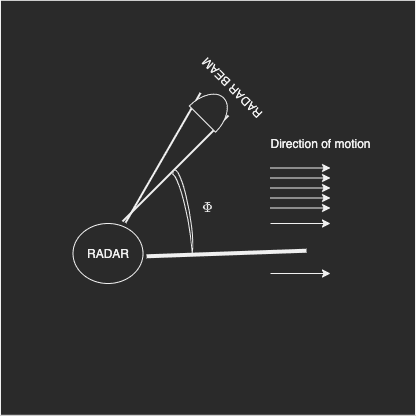

I want to simulate the time domain data for a rotating radar. I assume that the space around the radar is filled up with a very big extended object and it moves with a constant speed in one direction. Picture attached.
Diagram of a rotating radar at left with a beam at angle Φ from a horizontal reference line, and a set of arrows labelled Direction of motion pointing right.
I don't take range information here. I am only concerned about the velocity as in all ranges I consider the velocity to be constant.

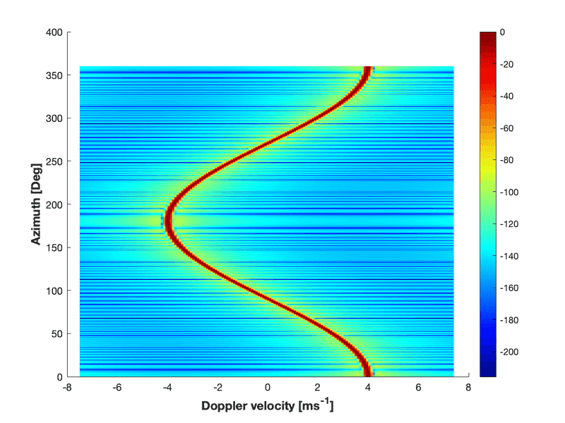

I did one simulation with the target motion direction as [itex]\phi_{wind} = 0[/itex] and [itex]\phi_0 = 0[/itex] . I have data for the entire rotation and I plot a micro-doppler spectrogram. I have [itex]167\times360[/itex] points for one rotation. So, I do Doppler FFT processing for every one degree of [itex]\phi[/itex] (167 points DFT) and plot it. Figure attached.
Colour heatmap of Doppler velocity in m/s against azimuth in degrees, with a red S-shaped curve of peak power from about 4 m/s at 0 and 360 degrees to about -4 m/s near 180 degrees.
Although it looks correct, I need a second eye who verifies my process here and if I am doing it alright physically. Physically radar receives the radial velocity and with that in mind, I formulated the phase of the time domain signal.

1. Is the radar fixed in one place ?
2. Does the target move in a straight line with a fixed velocity ?
3. Is the target a single point reflector, or is it a flock of scatterers that surround the radar in all directions like a local dust storm or snow storm ?

1. The radar is fixed physically at one place but its beam, which is narrow (1-degree beamwidth) is rotating from 0 to 360 deg in this case in the azimuth.
2. The target here is an extended target (yes, like a cloud) and it moves with a constant velocity in a constant direction (here it is [itex]\phi = 0[/itex] or you can say x-axis direction in the 2D plane)
3. For this question I consider monochromatic velocity, but at the same time, I consider a big cloud surrounding the radar to make the question simple. However, in my actual model, I use a group of scatterers making a Gaussian spectrum for velocity. You should consider points 1 and 2 for this question. I can relate it with my own model after I see that it is in fact physically viable.

This is the spectrum function plotted and not the received signal. I didn't understand fully what you said. Did you mean it looks like the spectrum of a moving target but with an acceleration? Or do you mean a target that is rotating?
Yes, your plot is correct for a cloud moving towards the radar from azimuth zero, with a velocity of 4 m/sec.
The azimuth function will be simple; doppler velocity = cloud velocity * Cos( azimuth );
I note that with fixed azimuth, for a very narrow point beam, all returns from any range will have the same relative velocity, and so will have the same doppler shift.

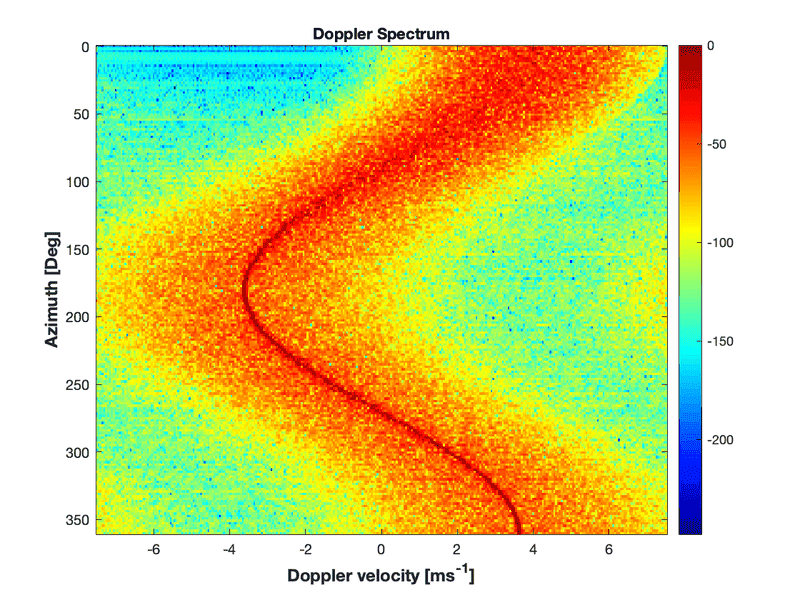

I liked the discussion. @Baluncore is right in understanding my problem and therefore, it is an extended cloud moving in one direction. However, now I have a more interesting problem and I think I solved it but I don't know how it worked. I need help in comprehending the mathematics behind it. The reality remains the same. extended cloud and it is moving in one direction that is zero azimuth. However, to make @sophiecentaur happy, I now consider different drop sizes in the cloud that move at different velocities. I assume the spectrum of this velocity of drops takes a Gaussian shape with a mean velocity ([itex]\mu[/itex]) and a standard deviation ([itex]\sigma[/itex]).
[tex]S(v) = \frac{1}{\sqrt{2 \pi \sigma^2}} e^{\frac{-(v - \mu)^2}{2 \sigma^2}}[/tex]
If I do an IFFT of the square root of this I get the time domain output.
After IFFT,
[tex]s(t) = A(t) e^{\Psi(t)}[/tex]However, this formula is valid if the radar is looking at the same direction of motion as the particles. I need to use a similar kind of transformation in the phase of this time-domain signal as I showed in my original post to have the information of the rotation.
There it was simple. It was monochromatic and I multiplied [itex]cos( \phi(t) )[/itex] to it and integrated it to get the phase of the time domain signal. Here, it is not monochromatic. That is why I can't perform this integration directly.
if you see my last equation in the original post (it is missing a [itex]\mu[/itex] in the phase), you can find that the phase doesn't change linearly with time. That is the reason why I thought when doing an IFFT here for the Gaussian, probably the phase is already changing linearly with time ([itex]\psi(t) \propto t[/itex]). So, I used the same transformation from my original post, but I divide it with the time axis.
[tex]s(t) = A(t) e^{\Psi(t) \frac{sin(\Omega t)}{\Omega t}}[/tex]
If this is my time-domain signal and I perform a spectrogram, I get the following result for [itex]\mu = 4 [m/s][/itex] and [itex]\sigma = 1 [m/s][/itex] . This is the desired result but it is not very symmetric. Azimuth zero and 360 should show the same spectrum, but it is different. It is probably due to this transformation in phase.
If the cloud is moving in one direction, from az = 0° to az = 180°, then there are two azimuths, az = 90° and az = 270°, where the doppler shifts of all reflectors will be zero. I do not see those zero width points without any Gaussian distribution on your plot.
I would expect you must scale the width of the velocity distribution by Cos( azimuth ).
I know how it should look like. however, I am not able to do the mathematics when I need to use the rotation information in the time domain. That is doing something in the phase of the original Gaussian signal [itex]\Psi(t)[/itex].
