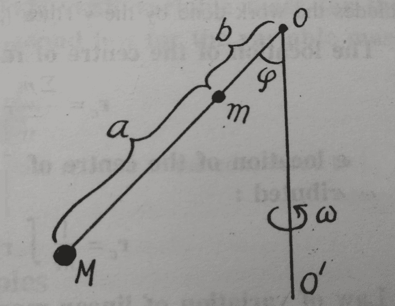

1. A weightless rod carries towards of masses M and M. The roads Hinge Joint to vertical axis OO', which rotates with an angular velocity ω. Determine the angle φ formed by the rod and there vertical.
The attempt at a solution
If I am not wrong, the two ways to ensure equilibrium are ensuring net force=0, or net torque=0.

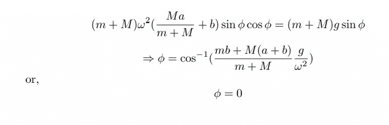

i) Net force=0:
The center of mass of the system will be at a distance $$\frac{Ma}{m+M}$$ from mass m between M and m.
Therefore the F=ma eqn. perpendicular to the rod for the imaginary mass (m+M) seems to be
Now, the second ans, φ=0, is given in the book in the ans section, but the first ans is wrong.
If we start balancing the torque, then this eqn. comes again as the distance between the hing and the point of actions of the centrifugal forces are same.
Above is the answer given in the book.

You can't replace the two forces by the force the sum of the masses at the center of mass would experience. The force is not linear with distance.
Would you please explain which two forces are you talking about? The centrifugal or the weight? And what is meant by forces not being linear with distance?
Ah my mistake, as they rotate in a fixed arrangement it will work in this case.
How did you set up your equation? As far as I can see you set forces equal that go in different directions. There will be a net force on the support. Only torque balance gives you a condition for the equilibrium.
Also note that your answer has inconsistent units, you can only take the inverse cosine of a number without units. That is always a certain sign that something is wrong (but here it was from an unrelated mathematics error).

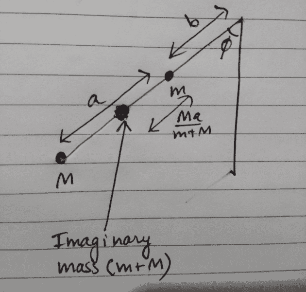

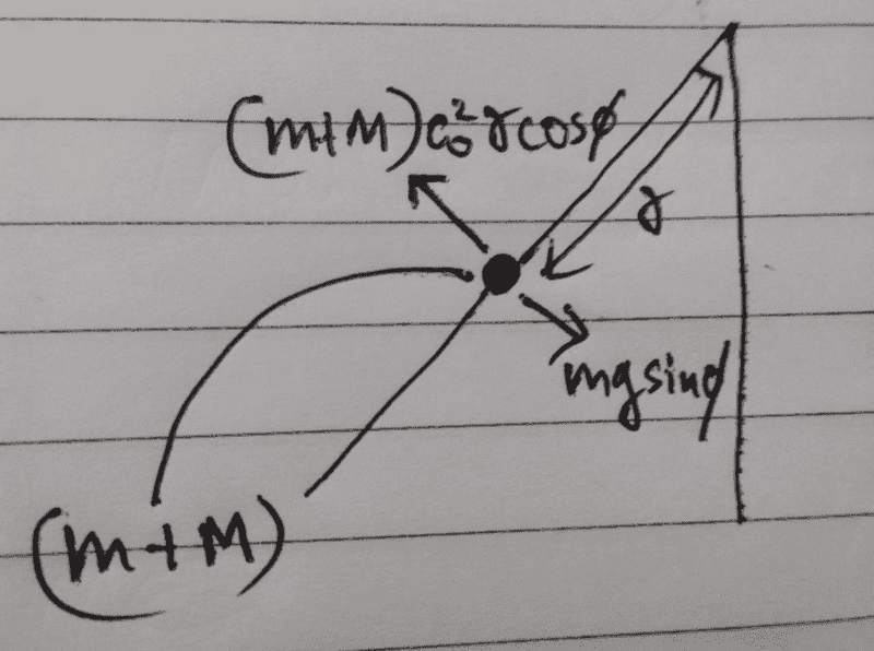

Below is the FBD for the imaginary mass:
According to me, the value of r is [Ma/(m+M)] + b
Now, please explain me why this will not work.
Sorry, there is a small error in the second image... the force mgsinφ should be (m+M)gsinφ

These are not the directions of forces. And while you could combine the two masses to one to consider forces, you can't do it for torque. You'll have to consider the masses separately.
I agree with you that balancing the torques will give an equilibrium condition. Also, I have reached the correct ans by balancing the torques. But will also balancing forces on the COM not give an equilibrium condition?

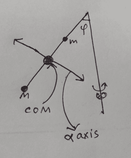

I have marked both the masses along with the center of mass of the rod. α axis is an axis defined by me as shown in the diagram. It is perpendicular to the rod.
Now, my question is, if we balance the forces on the COM along the axis and ensure that there is no movement of the COM along the α axis, then does this not imply and is implied by the fact that the rod will not rotate about the hinge?
That doesn't quite define it. If it is perpendicular to the rod but in the plane containing the rod and the rod's axis of rotation then it is of no relevance. All the forces will pass through that axis (or be parallel to it) and so have no moment about it.
When I wrote post #8 I was thinking of it as essentially a two dimensional problem, which it is. All the forces are in one plane and all the torques are therefore about axes normal to that plane. So when I wrote "any axis will do", I meant any axis normal to the plane.
If your α axis is indeed intended normal to the plane then I do not understand your later remarks. There are no forces along such an axis.
I did not write my post #9 based on your #8. My α axis is on the plane and not normal to it and perpendicular to the rod. And I balance forces along this axis on the COM.
In that case, my response to post #9 is that those forces will include an unknown force from the hinge, so does not allow you to deduce the angle without further equations. And as I showed in post #8, at least one equations will have to be a torque equation.
What is meant by unknown force from hinge? And why will it not be there while considering torque?
The rod is supported and restrained by the vertical axle. That axle must exert a vertically upward force on the rod to prevent its sliding down, and a horizontal force to prevent its flying away from the axle. No matter which direction you choose to resolve forces along, one or both of these will feature in your equation, and you do not have independent way to determne either.
If you take moments about an axis that passes through the line of action of a force then that force has no moment about the axis, so can be ignored.

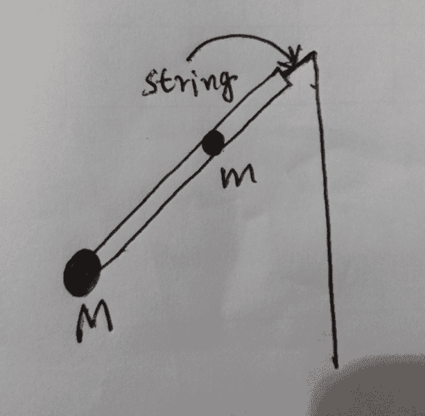

This is a new system.
All things are same, only in this case, the rod is attached to an ideal string with very small length.
Here, the tension acts on the rod parallel to it(along it, to be more specific). So, no force acts along the α axis, and my math works here, does it not?
You are assuming the rod and string would lie in a straight line. That needs to be proved.
You can't prove something that is not true.
