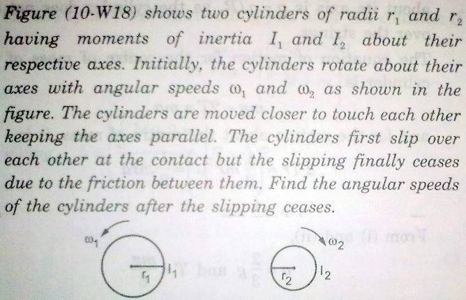

The book did it like taking impulse of forces f and writing eqn Impulse = Δ(Angular momentum)
or J = ΔL

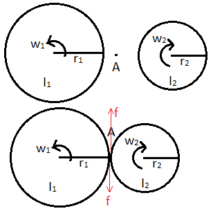

How i tried:
let the 2 cylinders meet at A
(they have not mentioned the velocity of approach but as it says that the 2 cylinders remain in contact and don't fly off after collision so i guessed that velocity is negligible)
Considering Torque at A
As no torque acts during whole process so L about A remains constant
[tex]L_{initial} = I_1w_1 \ - \ I_2w_2[/tex]
now let that after they meet and friction does it work they have angular speeds w1' and w2'
[tex]L_{final} = I_1w_1' - I_2w_2'[/tex]
and also
[tex]w_1'r_1 = w_2'r_2[/tex]
as the point of contact of 2 cylinders has same velocity
But this gives wrong answer!
Can someone tell me why this method is wrong?

hi cupid.callin! :smile:
your method should work :confused:
can i check … when you said …
… did you calculate L using the moments of inertia about the centres (which is correct), or about A (which isn't) ?
moment if inertia of a body about any point,
[tex]\vec{L} = \vec{L}_{CM} + m\vec{r}X\vec{v}_o[/tex]
where vo is velocity of CM
And as i said that cylinders do not fly away after collision, vo ≈ 0
So
[tex]\vec{L} = \vec{L}_{CM}[/tex]
And if the torque about A is zero then shouldn't momentum be conserved about A and thus calculate moments of inertia about A ?
If i calculate moments of inertia along CM then the friction will have torque and then momentum is not conserved !
yes, that's right …
LA = Lc.o.m.
but you said you used the formula Iω for LA, so i was just checking whether you used IAω or Ic.o.m.ω :wink:
