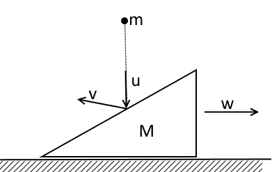

Nevertheless not all problems about collision are so trivial. Consider a wedge of mass ##M## that rests on a smooth horizontal floor. The slope of the wedge is also smooth. The wedge can not lose contact with the floor. It is an ideal constraint. Somebody drops a point mass ##m## on the wedge such that this point mass falls onto wedge with vertical velocity ##u##. It then bounces from the wedge with velocity ##v## and the wedge begins to move with velocity ##w##.
The velocity ##u## is known, the impact is perfectly elastic. Find ##v,w##.
  • #54
The velocity ##u## is known, the impact is perfectly elastic. Find ##v,w##.View attachment 196007
##w=\frac{mu\sin(2\theta)}{M+m\sin^2(\theta)}##

  • #56
Yes. And I forgot to introduce angle :(
