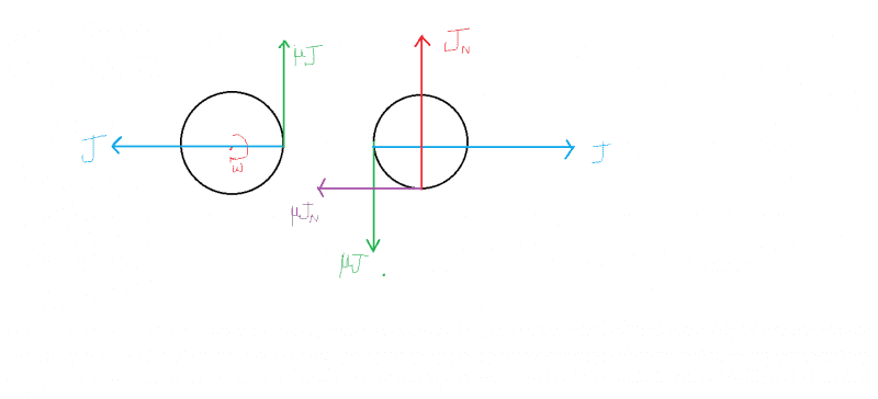

A solid cylinder of radius R is rolling without slipping on a rough horizontal surface. It collides with another identical cylinder which is initially at rest on the surface. The coefficient of restitution for the collision is 1.The coefficient of friction between the cylinders and between each cylinder and the ground is ##\mu##.If the final angular velocity of the second cylinder after it starts pure rolling is ##a/b## where a and b are co prime positive integers find a+b.
Given: Initial velocity of center of mass of the first cylinder is 17.5 m/s, R=1m, ##\mu##=0.5
##J=m(vf-vi)##
##L_{J}=I(\omega_{f}-\omega_{i})##
I think the main challenge is to find the velocity of the CoM and the angular velocity of the second cylinder after collision. Then the final angular velocity can be found by conserving angular momentum about the point of contact of cylinder and ground.
I began in his way-----
I made the Free Body diagrams
Let the initial velocity of the CoM (of cylinder 1) of the cylinder and initial angular velocity of the cylinder be ##v## and ##\omega## respectively. Let ##\omega## be in clock wise direction initially.
Let the final velocity of the CoM of (of cylinder 1) the cylinder and final angular velocity of the cylinder be ##v_{0}## and ##\omega_{0}## respectively. Let ##\omega_{0}## be in clock wise direction.
Let the final velocity of the CoM (of cylinder 2) be ##v_{1}## and angular velocity be ##\omega_{1}## in anti-clock wise direction.
As net impulse is equal to change in momentum and net angular is equal to the change in angular momentum so
## J=m(v_{0}+v)##.....(1)
##\mu JR=I(\omega_{0}-\omega)##.....(2)
For cylinder 2
As the cylinder don't jump so
##\mu J=J_{N}## (I have neglected mg as it is very small as compared to the impulses)
##J-\mu J_{N}=mv_{1}##
##I\omega_{1}=(\mu J-\mu J_{N})R##
If we consider the time period of the collision is very small so I think we can neglect work done by friction during the collision and as the collision is elastic so I think we can conserve energy. So
##\frac { 1 }{ 2 } \left( m{ v }^{ 2 }+I{ \omega }^{ 2 } \right) =\frac { 1 }{ 2 } \left( m{ v }_{ 0 }^{ 2 }+m{ v }_{ 1 }^{ 2 }+I{ \omega }_{ 0 }^{ 2 }+I{ \omega }^{ 2 }_{ 1 } \right) ##
Are my all equations correct?

In case of extended bodies we have to consider the velocities of the point of contact of bodies. Right?
As the collision is elastic so we can equate the velocity of approach and separation in common normal direction.
So ##v=v_{0}+v_{1}##

I am getting ##{ v }_{ 1 }=\frac { 6\times 17.5 }{ 7 } ##
and ##{ \omega }_{ 1 }=\frac { 4\times 17.5 }{ 7 } ##
and final angular velocity when it starts pure rolling as
##{ \omega }_{ final }=\frac { 20 }{ 3 } ##
Am I right?
Am I right?
That's what I get using the relative velocity interpretation of the coefficient of restitution.

My solution is wrong. In this I have assumed that limiting value of friction acts between cylinder and cylinder 1 slips over cylinder 2. However we can't do so. One of my friend has shown that friction between cylinders is sufficient for cylinder 1 to roll over cylinder 2. He got final ##\omega=455/48##. I am convinced with his solution. What do you guys think?
Satvik Pandey said:
No problem.:smile:
It seems to me that the coefficient of friction given in the problem must be for kinetic friction. You need the coefficient of kinetic friction to determine how far cylinder 2 travels before it starts rolling without slipping. A coefficient of restitution greater than zero implies that the cylinders separate after the collision. So, I don't see how cylinder 1 is going to roll up over cylinder 2. Maybe I'm overlooking something.

It is quite impossible for the first cylinder to roll over the second. The instant after impact, it cannot have a greater horizontal speed than the second since that would mean the two intersect. Since it will become airborne, the two therefore separate.
It is true that the second cylinder will now have backspin, so will lose some of its horizontal speed, so perhaps the first can catch it up, but I very much doubt it.
I agree that cylinder 1 will not roll on 2 forever. I am saying that cylinder 1 can roll over cylinder 2 during small time period in which collision occurs if the friction is sufficient.

Oh, you mean rolls against, i.e. instantaneous rolling contact.
Excellent point. Yes, I believe you are right. I get that if mu is the coefficient of friction between cylinder and ground then it will be rolling contact provided the coefficient between the cylinders is at least 2/(10-3 mu), which it will be. Can you confirm that calculation?
Yes I was talking about instantaneous rolling contact.:woot:
My friend got ##J=\frac{17mv_{0}}{16}## and ##J_{f}=\frac{mv_{0}}{4}##
From here limiting value of ##J_{f}=\frac{17mv_{0}}{32}##
As ##\frac{17mv_{0}}{32}> \frac{mv_{0}}{4}##. So the ball rolls.
