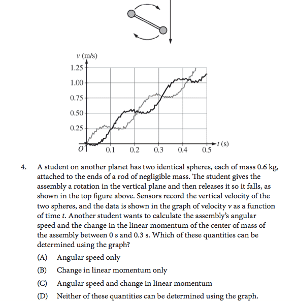

Hey guys,
I'm having trouble understanding this problem that was on an AP Physics 1 sample questions page:
So a couple of questions here:
(By the way, I know the answer is C)
1. My teacher explained that the net torque here on the assembly would be zero(will ask him again later). Is this because the torque was already applied at one point in time, and now the two masses are not accelerating?
2. Why does the graph have curves? Does it have to do with gravity changing the speed of the masses?

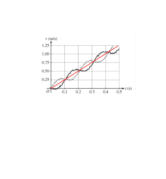

What I do know is the acceleration of the COM straight down, due to gravity. This can be found by the points on the graph that meet:
It would be awesome if you guys could help me out :)
The rotation was initiated at the beginning. Gravity itself will give no torque relative to the centre of mass by definition of the centre of mass.
Clearly, the masses are changing their velocities and therefore accelerating. However, the rotation remains the same.
No. There is an internal force due to the connection between the masses.

What do you mean by internal forces?
Forces that act between different parts of the system, in this case between the two masses.
I don't think I understand what you are talking about. Could you elaborate on the internal forces, and perhaps draw a diagram?
Thanks :)
There is tension in the bar connecting the masses. The internal forces are the forces mediated by this bar.
So this force causes acceleration, which in turn causes the graph to curve(change velocity), correct?
Right.
Also, would the tension force count as centripetal force, towards the COM, since the COM is the axis?
Yes, this force is in the centripetal direction. So it is a centripetal force.
