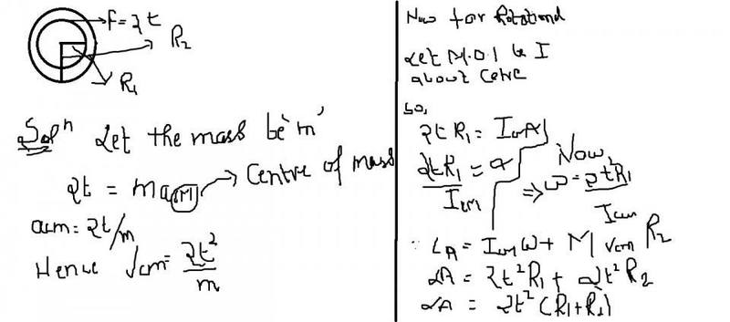

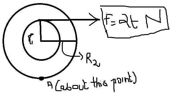

a spool of radius R1 and R2 (R2>R1) is kept on hortizontal surface. A force f= 2t N (where t is time ) acts on the inner radius tagentially find the angular momentum of the system about the bottomost point of the spool.
v=u+at
W=Wi+alpha(t)
L=IW+mvr
but the answer is t^2(R1+R2)
Where is the pool fixed at the center or at the indicated point?
It's not fixed ...it's on the floor free to rotate and translate

In your calculation of the linear acceleration you have ignored friction at the ground. Not sure if you did the same with the moments.
Please do not post working as images. Use images for diagrams and textbook extracts. Take the trouble to type in your algebra.

You say F = 2t what about direction? Then you want angular momentum at what time. If time varying force is acting neither the momentum nor angular momentum will be constant.
Likes Yash123
