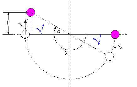

Two 2.1 kg balls are attached to the ends of a thin rod of negligible mass, 63 cm in length. The rod is free to rotate in a vertical plane about a horizontal axis through its center. With the rod initially horizontal as shown, a 50 gm wad of wet putty drops onto one of the balls with a speed of 3.9 m/sec and sticks to it. a) What is the angular speed of the system just after the putty wad hits?

c) Through what angle will the system rotate until it momentarily stops?
ΔΘ = rad
Im not sure how to approach part c since I don't know the acceleration or the time it takes to stop.

The height that's calculated will be the distance above the initial height (rod horizontal) that the wad must reach. Immediately after impact the wad is heading downward and picking up speed, maxing out at the bottom of its arc. It then proceeds up the other side, losing speed, until the rod is once again horizontal and the speed is the same as the initial speed, and the KE is the same as the initial KE. After this it continues upwards until it reaches height h above the horizontal.

Now, the ball with the wad travels around in its arc attached to the rod end until the rod is once again horizontal. That's an angle of pi radians so far traveled. At this point the system has the same KE as it had when the wad of putty first struck. As the wad rises above the horizontal, the system loses KE to gravitational PE.
So how high must the wad of putty rise in order to "steal" all of the rotational KE?
h = KE/(m*g)
What value do you get for h and the resulting angle above horizontal? (an angle which must be added to the angular distance already traveled by the ball and wad).
