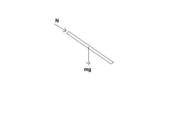

A slender rod shown in the figure has a mass m and length l and is released from rest when theta=0 degrees. The horizontal and vertical components of force which the pin at A exerts on the rod at the instant shown in the figure is ?
I have some basic problems with this question.
The pivot at A exerts a normal force along the rod. Is the magnitude of this normal force equal to that of the tension in the rod?
The force of the pin on the rod is equal to the tension in the rod at A, but the tension is not constant along the rod.

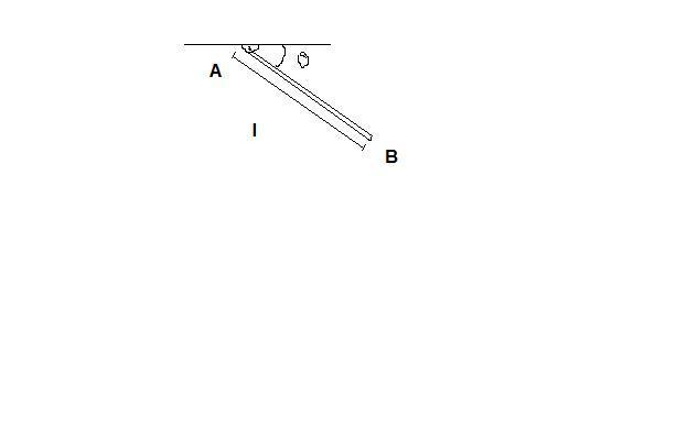

Ok, I drew this F.B.D. from what I understood:
In the problems of a mass attached to a string and rotated in a vertical circle, we have tension acting on the mass towards the centre.
But I don't find any force towards the pivot/pin which is responsible for the centripetal force.
Normal force will act in opposite direction. That along with component of Mg along the rod will give centripetal force.
The pivot can both pull and push the rod.
