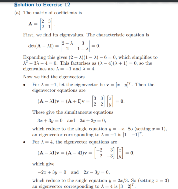

Hi; struggling a little with eigenvectors;
I can get to the equation at the foot of the example but I can't understand the "formula" leading to the setting of x = 3 at the foot of the example?
The ##x## there can be anything except ##0##. Setting ##x=3## simplifies the numbers.

Which steps are not clear? There are only three.

Do you understand how to get ##y=2x/3## in the penultimate line? If so, what that is telling you that any vector ##(x\ y)^T## where y is 2/3 of x is an eigenvector. So ##(3\ 2)^T## or ##(48\ 32)^T##. Typically you pick the vector with magnitude 1, but here they've just picked one that has nice round values for thr components.

The problem doesn't seem to be about conversion, but rather, one of comprehension on just what an eigenvector and its associated eigenvalue are all about.
For a given matrix A, an eigenvalue (usually represented as ##\lambda##, the Greek letter lambda -- note the spelling) is a number such that ##A\vec x = \lambda \vec x## for some nonzero vector ##\vec x##. There is not just one eigenvector for a given matrix and one of its eigenvalues. For a given eigenvalue, any constant multiple of a known eigenvector will also be an eigenvector.
For the problem in this thread, with the eigenvalue ##\lambda = 4##, all eigenvectors <x, y> satisfying the equation ##y = \frac 2 3 x##, where x can be any real number except 0.
All of the following are eigenvectors:
<3, 2>
<6, 4>
<1, 2/3>
<-9, -6>
etc.
It might be useful for you to verify for each of the above vectors that ##A \vec x = 4 \vec x##.
You can think of this matrix as a linear transformation that takes any input vector ##\vec u## and creates a new vector ##\mathbf A \vec u##. There are always some special vectors that are transformed into new vectors that have their direction unchanged. These are the eigenvectors. However, their length is changed by the factor ##\lambda##, the eigenvalue. Every eigenvector has an associated eigenvalue. Hence the key formula ##\mathbf A \vec v = \lambda \vec v ##. A vector that satisfies this equation is, by definition, an eigenvector with it's associated eigenvalue. But since the transformation is linear, we also know that for a scalar constant c, then ##\mathbf A (c \vec v) = c \mathbf A \vec v = c\lambda \vec v = \lambda (c \vec v)##. So the only important feature of the eigenvector is its direction. It's really a set of vectors with a fixed direction and any (non-zero) length. That is why once the derivation determines that ##\vec v =
\begin{bmatrix}
x\\
\frac{2x}{3}
\end{bmatrix}##, Then you can choose any value of x. Your choice only effects the length of that vector. They chose ##x=3## because it looks pretty.
Try it out. Multiply a few eigenvectors to see the results, it's not too hard in 2 dimensions.
PS: There is a confusing bit about how people often speak of the plurality of "eigenvectors".
##\begin{bmatrix} x\\ \frac{2x}{3} \end{bmatrix}## is an eigenvector. ##\begin{bmatrix} 3\\ 2 \end{bmatrix}##, ##\begin{bmatrix} 6\\ 4 \end{bmatrix}##, and ##\begin{bmatrix} -27\\ -18 \end{bmatrix}## are the same eigenvector. As I said before it's a set of vectors.
OTOH, ##\begin{bmatrix} x\\ -x \end{bmatrix}## is the other eigenvector. It could also be ##\begin{bmatrix} 1\\ -1 \end{bmatrix}##, ##\begin{bmatrix} -1\\ 1 \end{bmatrix}##, etc.
People can be sloppy here and context is important. Normally when we say the eigenvectors we mean the different sets of eigenvectors. So, 2 eigenvectors really means 2 different sets of vectors with each set having a fixed direction for all of its vectors. i.e. 2 directions, not just 2 vectors.

Just to make explicit a step that DaveE's excellent explanation skipped, if ##\mathbf{A}\vec v=\lambda \vec v## then ##0=\mathbf{A}\vec v-\lambda \vec v##. We'd like to take the common factor of ##\vec v## out so we can write something like ##0=(\mathbf{A}-\lambda)\vec v##. But how? What does it mean to subtract a number from a matrix? There isn't an answer to that question, but we can note that multiplying a vector by the identity matrix, ##\mathbf{I}## does nothing. So we can write $$\begin{eqnarray*}
0&=&\mathbf{A}\vec v-\lambda v\\
&=&\mathbf{A}\vec v-\lambda\mathbf{I}\vec v\\
&=&(\mathbf{A}-\lambda\mathbf{I})\vec v
\end{eqnarray*}$$We know how to multiply a constant by a matrix (multiply each element of the matrix by the constant) and we know how to subtract one matrix from another (subtract the corresponding elements in the two matrices).
That's where the matrix$$\left[\begin{array}{cc}-2&3\\2&-3\end{array}\right]$$comes from. The top left element of ##\mathbf{A}## is 2, the top left element of ##\mathbf{I}## is 1, and ##\lambda## is 4. So the top left element of the matrix is ##2-4\times 1=-2##. Multiplying the matrix by the vector ##(x\ y)^T## gives you a vector equation containing the two equations immediately below.

All vectors on the strait line ##y=-x## are eigenvectors of A with the same eigenvalue ##\lambda=-1##
also
All vectors on the strait line ##y=2x/3## are eigenvectors of A with the same eigenvalue ##\lambda=4##
There is no "formula" to pick one vector from each of two strait lines.
You can choose any number for x . As you like .
( That is "THE FORMULA") :-) Sorry, but this is so funny to me ... "freedom of choice formula"
Probably the most important formula in a life.
In the example you posted
##x=1## is chosen for the first line and eigenvector from the first strait line is (1,-1)
##x=7## can be chosen for the first line and eigenvector from the first strait line will be (7,-7)
##x=3## is chosen for the second line and eigenvector from the second strait line is (3,2)
##x=-6## can be chosen for the second line and eigenvector from the second strait line will be (-6,-4)

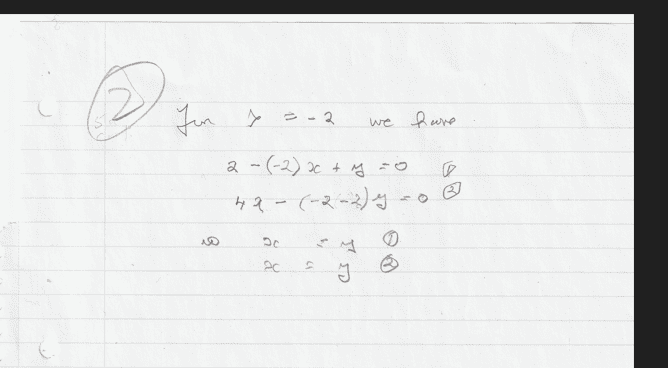

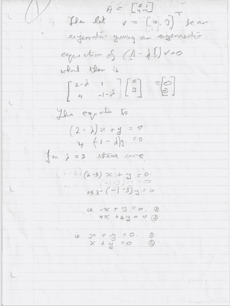

You have been so helpful, hopefully I am getting there.
As below given x=y can is assign any value to x so that y has a corresponding value?
thanks martyn

Let me do this task from the previous post.
First you need to find eigenvalues.
##det
\begin{bmatrix}
2-\lambda&1\\
4&-1-\lambda
\end{bmatrix}
=0##
##(2-\lambda)(-1-\lambda)-1 \cdot 4=0##
##(2-\lambda)(-1-\lambda)- 4=0##
##-2-2\lambda+\lambda+\lambda^2-4=0##
##\lambda^2-\lambda-6=0##
I need to find solutions ##\lambda_1## and ##\lambda_2##. There are many ways to find them.
[1] Standard formula (copy/paste from Forum > Help > LaTeX)
##\lambda_{1,2}= \frac {-b \pm \sqrt{b^2 -4ac}} {2a}##
[2] You can use Vieta's formulas. What are those two numbers?
When you add them together, you will get a minus coefficient in front of the lambda ##\lambda^2+(-1)\lambda-6=0##
##\lambda_1+\lambda_2=-(-1)=1##
When you multiply them, you will get the last number from the left side of the equation ##\lambda^2-1\lambda-6=0##
##\lambda_1 \cdot \lambda_2=-6##
Can you guess what those two numbers ( ##\lambda_1## and ##\lambda_2##) are?
[3] Complete to a "complete square". Add 1/4 to both sides of the equation
##\lambda^2-\lambda+\frac{1}{4}-6=0+\frac{1}{4}##
##\lambda^2-\lambda+\frac{1}{4}=6+\frac{1}{4}## ... left side is a "comlete square"
##(\lambda-\frac{1}{2})^2=\frac{24}{4}+\frac{1}{4}##
##(\lambda-\frac{1}{2})^2=\frac{25}{4}##
##\lambda-\frac{1}{2}=\pm \sqrt{\frac{25}{4}}##
##\lambda-\frac{1}{2}=\pm \frac{5}{2}##
##\lambda-\frac{1}{2}=\pm 2\frac{1}{2}##... two and a half
##\lambda_1=+ 2\frac{1}{2}+\frac{1}{2}=3##
##\lambda_2=- 2\frac{1}{2}+\frac{1}{2}=-2##
These are two eigenvalues.
Now I will find eigenvectors
[1] For eigenvalue ##\lambda_1=3## I get
##\begin{bmatrix}
2-3&1\\
4&-1-3
\end{bmatrix}
\begin{bmatrix}
x\\
y
\end{bmatrix}
\begin{bmatrix}
0\\
\end{bmatrix}
##\begin{bmatrix}
-1&1\\
4&-4
\end{bmatrix}
\begin{bmatrix}
x\\
y
\end{bmatrix}
\begin{bmatrix}
0\\
\end{bmatrix}
##-x+y=0 ##
##4x-4y=0##
These two equations are equivalent (have the same set of solutions). If you multiply the first by -4 you will get the second. There is no need to solve them both. It is enough to solve only one.
##y=x ##
The solution set is a straight line with infinitely many eigenvectors for the same eigenvalue ##\lambda_1=3##. I need to choose one.
For x=42 I get eigenvector ##v_1=(42,42)##
For x=1 I get eigenvector ##v_1=(1,1)##
[2] For eigenvalue ##\lambda_2=-2## I get
##\begin{bmatrix}
2-(-2)&1\\
4&-1-(-2)
\end{bmatrix}
\begin{bmatrix}
x\\
y
\end{bmatrix}
\begin{bmatrix}
0\\
\end{bmatrix}
##\begin{bmatrix}
4&1\\
4&1
\end{bmatrix}
\begin{bmatrix}
x\\
y
\end{bmatrix}
\begin{bmatrix}
0\\
\end{bmatrix}
##4x+y=0 ##
##4x+y=0##
These two equations are equivalent (have the same set of solutions) because they are the same .:-)
##y=-4x ##
The solution set is a straight line with infinitely many eigenvectors. I need to choose one.
For x=1 I get eigenvector ##v_2=(1,-4)##
That is it.
As attacd given x=y can is assign any value to x so that y has a corresponding value?
thanks martyn
thanks martyn
You're welcome
Yes, you can assign any value to x (-13.5 , 1, 77,...) except of course 0.
