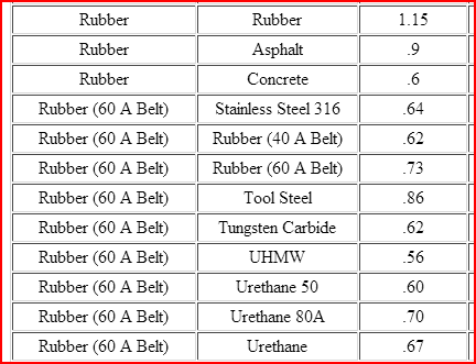

Coefficient of friction for tyre on steel is 0.3

Can you give a reference for that value of μs = 0.3 ?

Yeah, it looks to be a bit higher than 0.3, unless he is referring to some special rubber...
https://www.engineersedge.com/coeffients_of_friction.htm
Those “60 A belt” coefficients may be for Vee belts pulled into a pulley groove. Tool steel and stainless steel may have quite different values to mild steel plate due to their surface chemistry. Tyre on asphalt and on grass do not help.
The confidence of malemdk's μs = 0.3 with the the “tyre on steel” specificity, must have come from some source. It is sufficiently questionable that I should not really believe it until I see the reference. Maybe it allowed for a wet track, hard rubber, or just a guess by an examiner when setting an exam question.
