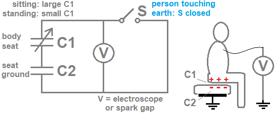

sophiecentaur said:
A mechanism that's often neglected is Electrostatic Induction and I think it is a more common way that things can become charged than simple 'charge sharing'
I agree it is a good exercise to compare the person to an electrophorus, and to consider the possibility of touching ground while seated, theoretically. However, I am not sure why you refrained from estimating the magnitude of your effect of touching ground while seated. See the figure. Suppose the penetration depth of the triboelectric charge is ~1 μm if the person is sitting, then the charge separation distance in C1 is ~1 μm, or less. In contrast, the separation distance in C2 is 1 cm or more. So merely ~0,01% of the charge of C1, or less, would be transferred to C2.
In practice, it is easy to verify that touching ground while seated hardly affects the excursion of the electroscope after rising from the chair, or the propensity to spark.
I was thinking about it differently. I assumed that the charge separation between chair and seat would be due to friction between seat and trousers. (Why do you estimate 10mm between body and seat? Clothing (compressed) would only be a mm or less.) Displaced charge on the body would travel to the car body through the wheel and controls. The charge separation process would be gradual as the driver fidgets in her seat so no shock experienced when touching the wheel. You operate the door lock before you move off the seat so no shock. You then slide out, which produces a high PD (Q=CV) and C reduces a lot due to separation. You then turn round and touch the door and that's when you get the shock.
Then my diagram was not clear enough. The capacitors C1 and C2 together are a stack of three electrically charged layers: (A) the lower surface of the body, including the trousers, negatively charged due to the triboelectric effect; (B) upper surface of the seat cushion, positively charged due to the triboelectric effect; (C) the chair frame that supports the cushion, connected to Earth or the car body. C1 is the capacitor AB; C2 is capacitor BC. The distance between the charges of A and B is very small. The distance between B and C is the thickness of the cushion, at least 1 cm.
Right - I get your model now. However, I would suggest that the charge separation would occur whilst sliding / exiting and the charges would be right on the surface of the seat.
