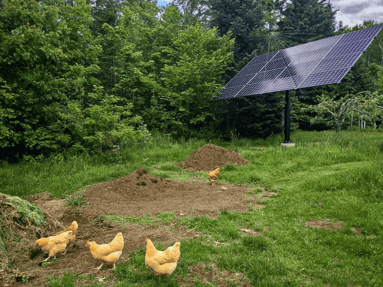

My friend here in Vermont has this fancy solar array with position tracking plus two Tesla power wall units. I asked him how much energy he gets in December. His answer, "Zero."
