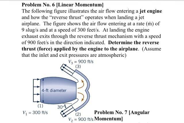

I have no idea what you would call it, but yes, it is a thing. Jet aircraft use that idea to go in reverse. They just bounce their backward facing jet exhaust into the forward facing direction so that they can go in reverse. They use metal ducts instead of a sail, but it is the same principle.
Wouldn't it simply be "directed air flow"?
I would call it thrust! The gases in a rocket engine do not care how many times they bounce around the combustion chamber...it is only the speed and direction of their final exit that matters.
Just a (more or less efficient) ducted fan.
