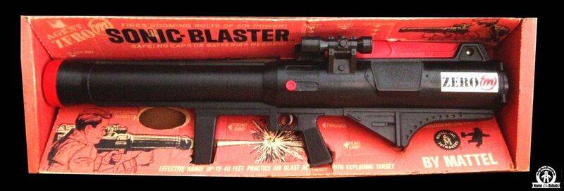

Does the air stream have to be continuous or can it be pulsed?
If it can be pulsed, maybe it could be based on the old toy air blaster bazookas and pistols. You could figure out why they were able to propagate the blast of air so far with little dissipation, and then extend that to some reasonable pulse rate (2-4Hz maybe?).
https://alphadrome.net/data/albums/userpics/10004/AGENT_ZERO-M_SONIC_BLASTER.jpg

Ah, I remember those pulse toys! In my experience they were used mostly to annoy other people! It looks like it's using a nozzle with an exponentially decreasing radius, over a large diaphragm.

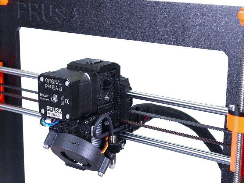

I didn't want to distract from the problem with my specific application, but specifically, I am experimentally trying to find a way to cool the extruder stepper motor on my 3D printer (https://all3dp.com/1/original-prusa-i3-mk3s-plus-review-3d-printer-specs/) without adding mass to the print head on which the motor is mounted. I figured I could install a 40mm diameter fan on the same Z-axis mount that the extruder gantry is on. Extra mass on the Z axis doesn't matter, but it does on the extruder that moves along the X-axis. The fan would then always be level with the extruder motor, blowing on it, but at varying distances (5-28 cm) as the extruder moves back and forth.
I don't want the fan to blow on anything except the extruder motor, to maximize cooling efficiency. I'd like to see if I can make a stream of air that maintains itself at about 40mm in diameter over a distance of 30cm before spreading out.

I'm having trouble imagining how that would work. This is what the extruder ("print head") looks like. The extruder motor that I want to cool is the cubical-looking object with the words on it. That motor is what forces the plastic filament (not shown) into the hot end at the bottom and out the nozzle. The angled round-ish object at the bottom is a centrifugal fan that blows air on the melted plastic coming out of the nozzle so that it hardens quickly.
I want to avoid adding any mass or inertia to the print head. That's why I was thinking of mounting a small fan with an appropriate collimator to one of the orange parts on each end of the X-axis (the two rails that the print head slides on left to right). I can re-print one of those orange parts to include a fan mount. The orange parts move in the Z direction (you can see the long vertical worm gear on the right edge of the image). It's OK to add more mass to the Z axis. The collimated "beam of air" would be aimed at the extruder motor at all times, and move vertically with it because both fan and extruder are attached to the Z axis motion.
Now, when you mention a helical plastic tube suspended from above, I am imagining a flexible coiled plastic tube attached to a shroud around the extruder motor, with the shroud guiding the air from the tube around it. Is that what you meant?
You might wonder why I want to blow air on this motor. 95% of the time it isn't necessary. However, over a print run that lasts many hours with many filament retractions, the motor's own self-generated heat creeps along the motor shaft and into the drive gear that's controlling the filament. This part cannot get too hot or the filament softens at the drive gear, and cannot be pushed cleanly into the hot end. The heat from the hot end is isolated from the drive gear by that aluminum heatsink behind the blower fan, and it has a separate fan that you cannot see in this image, blowing across that heatsink. That's quite effective. It's the heat creep from the extruder motor's self-generated heat that I'm trying to prevent.
This whole project is more of an excuse to figure out a way to focus a jet of air over a longer distance than it would normally have just coming out of a fan.
By the way, this printer is exceptionally quiet. We're in a small apartment with a combined living room and dining room. The printer is 4 or 5 meters away from the dining room table, and we don't even notice when it's running while we have dinner.

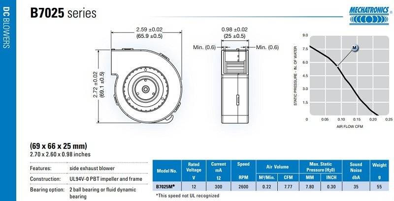

A properly sized centrifugal blower with a nozzle will blow air across the width of most small printers. A blower something like this, which I randomly picked from the Digikey catalog:
For this blower, I would size a nozzle for 0.10 CFM at 4.5 inches water pressure. I made no attempt to pick the right size blower for your application, this is the first one that came up. At the price of $15.00 plus shipping, you can easily buy two or three to find the right size by experimentation. Just size the nozzle for each blower so the the blower operates near the middle of the fan curve.

OK, a blower fan then. I'd probably use this one. I know such a fan can easily blow air across the width of the printer. The question is, how does the air jet spread? Ideally, the amount of air impinging on the motor housing should be about the same 5 cm away or 30 cm away.
