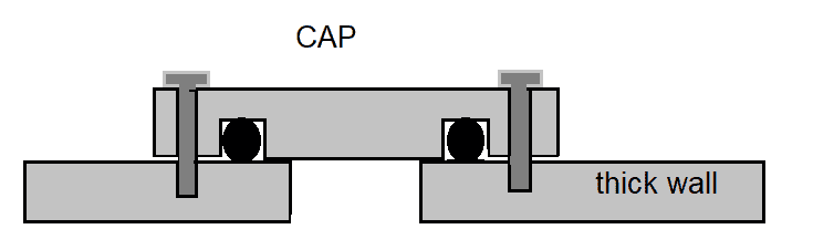

I'm not sure what was done but this is how I think it should have been done.
O-rings seal by being pushed against the joint by differential pressure.
For a vacuum, the cap offset should be the negative of what you show. The system shown would seal against high internal pressure as the o-ring would increase in diameter to make the seal.
As shown, the o-ring will be pushed against the opening on the vacuum side, which will damage the surface of the o-ring as it is extruded into the gap, against the sharp edge. That inner joint should have a very small gap, mostly metal-on-metal inside with the vacuum. There should be a bigger gap, maybe 0.1 mm, where the screws attach the cap, so atmospheric pressure can push the o-ring against the joint.

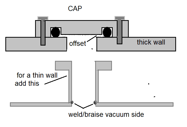

Like this?

I exaggerated the gap in my diagram. I do not think the O-ring's compression should be determined by the fastening screws but by the depth of the groove so the metal-metal contact should be on the atmosphere side of the O-ring. This also helps outgassing issues with metal-to-metal contact surfaces within the chamber.
gleem said:
I do not think the O-ring's compression should be determined by the fastening screws but by the depth of the groove ...
That is correct. An O-ring is not a gasket.
gleem said:
... so the metal-metal contact should be on the atmosphere side of the O-ring.
That is where we differ. What you write is true for pressure vessels, but not for vacuum chambers.
The O-ring in the groove, must close the gap above and below, yet still be free to slide radially between the two parts within the groove. Without that side closure, differential fluid pressure will not push the O-ring against the junction of the parts.
There should be a minimum gap between parts on the low-pressure side of the O-ring groove. That is where the pressure seal will occur, and where the O-ring will be extruded or damaged if there is any significant gap.
The differential pressure should increase the force that pushes the O-ring against the junction of the parts. Any gap on that sealing junction, will reduce the force multiplication by the differential hydrostatic pressure.
At least for O-ring materials and vacuum applications that I am familiar with it takes a lot of force to compress the O-ring sufficiently on the flat surfaces (the main sealing area) to ensure a seal compared to what atmospheric pressure can apply to push it in. The atmospheric pressure is 14.7lbs/in2 but the compression force per inch on 1/8 in. diam O-ring is a bit more than a pound/in, vs the fastener force of up to 15 lbs/ in. to compress it to the manufacturer's specs.
If you use the O-ring as a gasket it will be more difficult to seal than if the O-ring is in a groove. The O-ring only needs sufficient compression to prevent the high pressure moving above or below. Once the pressure is applied, the pressure will seal the O-ring in a groove, but not between two flat faces.
There are captive ring seals that are rubber bonded to a metal surround. They do not require a groove to retain the O-ring and prevent extrusion. When they are placed between flat faces, the rubber ring is forced against the metal outer, sealing against the flat surfaces. For a vacuum, the metal ring would need to be inside the rubber ring.
