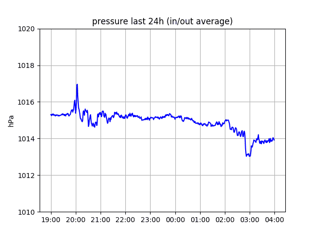

Weather station recording pressure at my home registered the shockwave from Tonga eruption twice, as it was traveling around the globe. That's expected, but what is the physics behind the fact second shockwave registered as a drop in the pressure, not as a spike?
I already posted this image in GD as a curiosity, but there is one thing that I don't get. This is pressure recorded by my weather station near Warsaw in Poland after the Tonga eruption (the description says '24 h' but it is wrong, I forgot to modify the script generating the plot). Around 20:05 there is a first pressure spike, then, several hours later, around 2:51 there is a second change in the pressure. In both cases timing and the distance agree with the expected propagation of the shockwave with the speed of sound, so there is no doubt these are both related and there is doubt first event is the shockwave propagating from the epicenter and the second event is the shockwave traveling around the globe back to Pacific. Identical (or at least reasonably similar) patterns were observed by other people in Poland at around the same time (give or take several minutes related to the distance).
But why is the second event a drop in the pressure? I expected it to be a spike as well, not a drop. In GD @Jonathan Scott suggested it can be effect of the wave going in a growing circle, but somehow I am not convinced.
(in case you wonder: I haven't seen the third shockwave, but at the time when it was expected there was a violent atmospheric front getting through here, so there was plenty of noise in the pressure measurements)

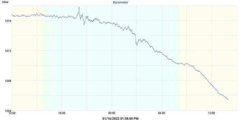

Similar patterns were observed in several places in the UK as well at similar times.

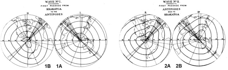

The pressure wave of the Krakatau that traveled around the world in 1883 seems to show the same effect: at the second visit of the wave, the negative peak is more conspicuous.

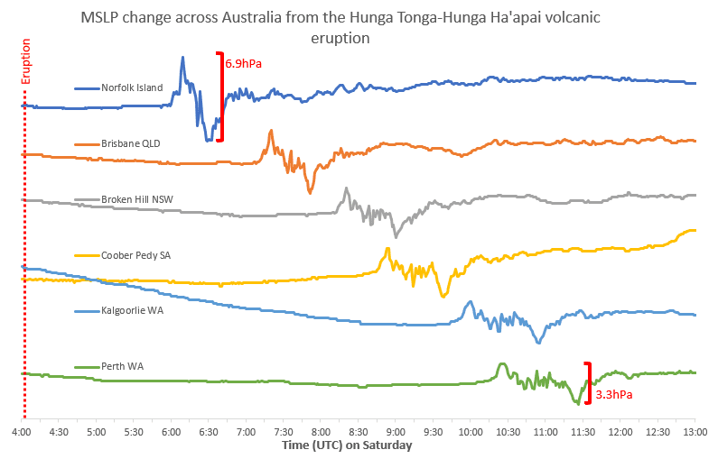

The Bureau of Meteorology, Western Australia twittered the following pressure recordings. Curiously, the positive peak and the negative peak do not have the same propagation speed.
That's very interesting, thanks. Clearly at that point the excess pressure lasted long enough to register directly, and we then see the rebound negative pressure. The overall effect is gradually getting smoothed and spread out.
However, the effects look symmetrical here, without an overall temporary higher or lower pressure, so I suspect that this close to the origin the displacement effect which I have suggested above is hidden by the direct effects of the pressure wave itself.
When extrapolating it back to the eruption of the vulcano, the negative peak occurred almost at the same time as the positive peak (less than 5 minutes later).

You might expect slow propagation over the poles because of the cold. That should have been visible in the isochrones of the pressure wave of the Krakatoa, especially in the center of figure 2B, the return of the pressure wave to Krakatoa after a full cycle around the earth. The isochrone in the center has lobes that depict the slowest arrival directions. Figure 2B shows that the slowest arrival directions are not those from the south pole and the north pole. Instead, the figure shows that the eastward travel around the world was 1 hour slower than the westward travel. This could be explained by the Trade Winds.
