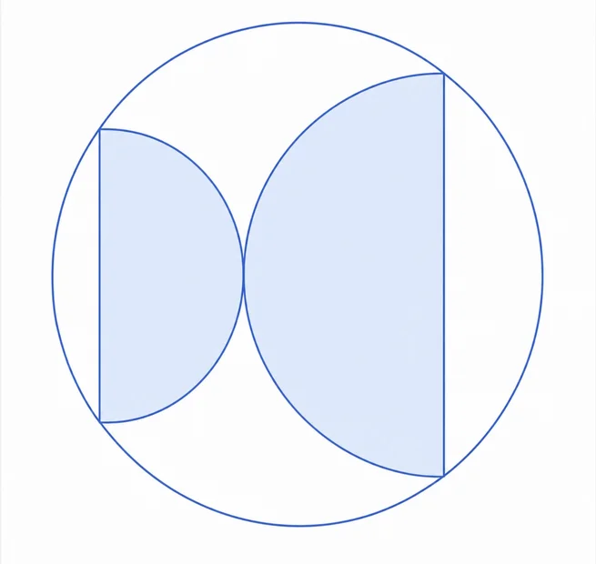

Here is a puzzle from Catriona Shearer. Find the area ratio of the shaded semi-circles to the circle which they fit in. The bases of the semi-circles are parallel.
Diagram of a circle with two shaded half-disc shapes inside it, each bounded by a straight vertical chord and a circular arc, the two arcs meeting at the centre of the circle.
Hint: consider the extreme cases to figure what the answer might be then prove the general case.

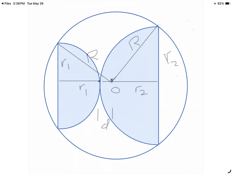

Hand-drawn diagram of two shaded half-disks inside a larger circle centred at O, with radii labelled r1 and r2 and a segment d between the two flat edges, and the outer radius labelled R.
Here is my proof.
$$r_1^2+(r_1+d)^2=R^2=r_2^2+(r_2-d)^2$$
Solving for ##d##$$d=\frac{r_2^2-r_1^2}{r_2+r_1}=r_2-r_1$$
Therefore $$r_1^2+r_2^2=R^2$$
And area ratio is $$\frac{\frac{1}{2}\pi r_1^2+\frac{1}{2}\pi r_2^2}{\pi R^2}=\frac{1}{2}$$
