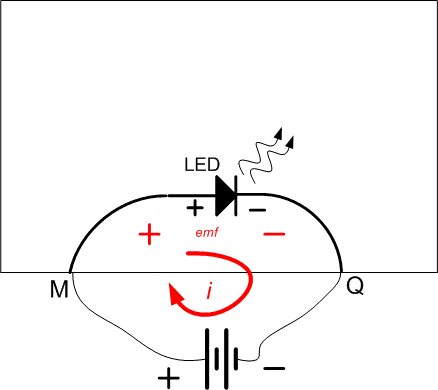

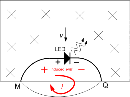

Abdul Quadeer said:
Oh yes - the areas swept are same.
So the induced EMF is E=2BRv
'Looks good to me. That's what I got for the situation where the entire semicircular piece of wire is in the field. :approve:

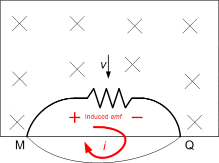

Last question - which point is at a higher potential - M or Q?
Recall,
F = qv x B.​
Now imagine that wire contains some positive charges on it (which it actually does. It also contains an equal amount of negative charges too, but let's just consider the positive charges for the moment).
Using the right-hand-rule (or whatever applicable rule you wish to use for the cross product), which direction would these positive charges be "pushed"?
Now, hypothetically, if you were to take the wire out of the magnetic field and attach it to the terminals of a battery, what polarity would use such that the current flows in the same direction as those positive charges were previously "pushed"?
(Now if you were curious and wanted to consider the negative charges too, they will be forced in the opposite direction that the positive charges were, in the situation where the wire is moving in the magnetic field. And when taken out of the field and connected to the battery, the "current" flows in the opposite direction as the negative charges, so the answer still comes out to be the same as before.)
The positive charges will be pushed towards right. So Q is at a higher potential.
Thanks a lot!
Thanks a lot!
Wait, hold on.
I agree that the positive charges would be pushed toward the right. :approve:.
But if you took the wire out of the magnetic field, attached it to a battery such that the battery's positive terminal was on Q and the negative terminal on M, the current (thus positive charges) would flow through the wire to the left.
So you should re-think that last part. :wink:
[Edit: If you'd like to think about it another way, the positive side of the induced emf is going to push the positive charges in the wire away from it. Which side of the wire are the positive charges being pushed away from?]

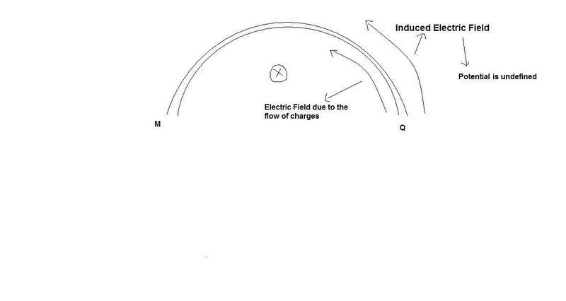

The ring doesnot form a closed loop. So you cannot hypothetically take the wire out of the magnetic field and attach it to a battery as that is applicable only in the case of closed loops :-p.

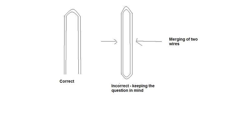

In my analogy if the two sides make contact along their length then the whole thing can be considered as a thicker single wire.It is the movement of charged particles(electrons)along the wire/ring that causes a negative charge to build up at one end with a resulting equal positive charge at the other and this is what actually causes the emf to be developed.Equilibrium is reached when the repulsive force per electron due to the charge build up becomes equal to the Lorentz force this being when e=Blv(l being equivalent length of structure)
If you consider the semi-ring to be a thick wire, then you are changing the question i.e. you are forming a closed loop ( by merging the open ends into one wire ). You can do something else - keep the wire insulated electrically and bring them close enough. Then apply what I told in my previous post. Refer the figure -
The distance between each wire is very very small. It is magnified for a clear view.

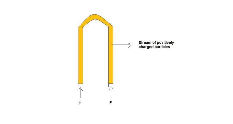

In your previous post you gave the example of the force on positive charges being upwards in both the left and right wire.Well,the force on like charged particles is indeed in the same direction for both wires,or in all sections of a single wire or whatever arrangement is used.It is only some electrons that are free to move and it is because the force is in the same direction for particles of like charge that an emf is induced in the first place so I don't understand your point.Are you saying that there are two forces in the same direction which cancel each other out.Anyway, its 12 ocklock here and time for bed.
Well I just modeled it that way to prove your point wrong. I assumed all the positively charged particles to form a continuous incompressible stream. There is a pushing force acting on each end of the vertical wires. If the stream of electrons in the left wire gets pushed upwards, the force in the right wire pushes it upwards to cancel the motion. Refer figure -
You can also consider it this way - the left end of the wire forms a positive terminal of an imaginary battery . Similarly the right end forms a positive terminal resulting in opposition of batteries and cancelling of e.m.f.
There can be some flaws in this explanation. I just modeled it my way.
But I still base my confident explanation in post number 24.
