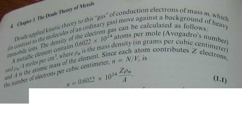

if we have a molecule or atom
then if we take avogadros number amount of this unit
then the amount will weight the atomic mass in grams.
[tex]\rho _m/A[/tex]
rho is the density
A is the atomic mass
why their dinviding gives us moles per cube cantimeter
In general, looking carefully at the units tends to help me understand physics. (BTW, solid state physics was the hardest subject for me.)
Anyway, we have this:
[tex]n = 0.6022 \times 10^{24} \frac{Z \rho_m}{A}[/tex]
Physicists have a nasty habit of leaving out units when they write equations in textbooks. That didn't stop the physicists in my EE department from marking my grade down when I forgot to put units on my test answers. YOU'LL GET YOURS ONE DAY PHYSICISTS!
Let's add the units:
[tex]n (#electrons) = 0.6022 \times 10^{24} \frac{#atoms}{mole} \frac{Z \frac{#electrons}{atoms}\rho_m \frac{mass}{cm^3}}{A \frac{mass}{mole}}[/tex]
You can see how the units cancel now. Does that help?
thanks :)
this is only the first question among many
to understand 4 chapters
thanks again :)
what is N?
in the N/V formula
Man, I can do anything these days without making an error. The correct units were:
[tex]n \frac{electrons}{cm^3}= 0.6022 \times 10^{24} \frac{#atoms}{mole} \frac{Z \frac{#electrons}{atoms}\rho_m \frac{mass}{cm^3}}{A \frac{mass}{mole}}[/tex]
To answer your last question:
[tex]n = \frac{N(electrons)}{V(cm^3)}[/tex]
Capital N is just the number of electrons and V is the volume.
