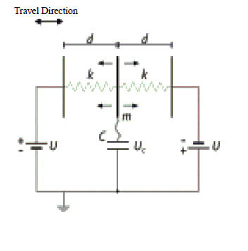

To trigger the airbag, accelerometers are used.
A simple sensor is composed of three parallel plates of the surface A, which are connected to a condenser system.
The mass m of the middle plate can move between the two fixed outer
Moving plates. She is stopped by two identical k, isolated springs of spring constants. The springs are not stressed when the plate is in the center.
To what maximum distance x, the middle plate
is deflected, when the vehicle is braked suddenly from movement at a constant acceleration a.
Determine how large the additional capacitance C must be when the airbag to trigger a voltage Uc = 0.15 V and this needs to happen at a speed of 10 ms ^ -2.
To use the values ​​d = 1.0 cm, A = 250 cm2, m = 50 g, k = 5.0 × 102 N m ^ -1 and U = 12 V.

To make to clearer for you how the sensor looks like I have got a picture of it.

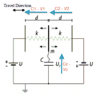

You still need to complete the expression for the displacement distance Δd in terms of the spring constant, the mass, and the acceleration. Leaving a new variable, W, in the expression is not useful.
You still need to analyze the circuit to determine the voltage across the unknown capacitor Vx in terms of the two varying capacitors Ca and Cb.

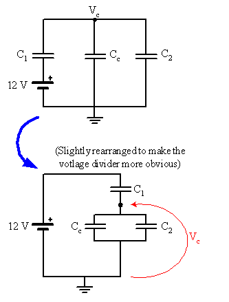

Here's your circuit:
There's no alternating voltage source in the circuit, and no resistors... just two 12V DC supplies and three capacitors. You'll probably want to use the capacitor voltage division rule and superposition to analyze the circuit. Here's the same circuit rearranged slightly with the capacitors made obvious:

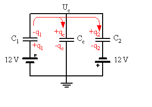

We still need to see a correct circuit analysis for the 3 capacitors and 2 voltage supplies. If you were given only the circuit which I posted in post #10, what expression would you derive for the voltage Vx?

The formula you've written for Cc doesn't look correct either. Is Cc meant to be the unknown central capacitor? Why not begin by writing the expression for the node voltage Vc in terms of Ca, Cb, Cc, and the 12V supplies? Put aside the expressions for Ca and Cb for now and just use the symbols Ca and Cb. Here's the circuit again using your choice of variable names:

My suggested approach involves two concepts. The first is the superposition principle whereby you can analyze a circuit by considering only one source at a time while the others are suppressed, then summing the the results. You should have seen this method and used it in basic circuit theory class. If not, you can research it online and find it explained with examples. Here's an example.
The second concept is that of voltage division by capacitors in series. Since components in series share the same current, the charge on two capacitors in series must be equal. Thus, if you know the total voltage across the capacitor string you can find the charge on both capacitors and thus the individual voltages on the two capacitors. If C1 and C2 are two capacitors in series and there's a total voltage V across them, then the voltage on capacitor C1 is:
$$V_{C1} = V \frac{C2}{C1 + C2}$$

Your circuit is slightly more complex. You need to analyze the circuit to find an expression for the center capacitor Cc according to your given criteria.

You have a circuit with three capacitors and two 12V voltage sources. You need to solve the circuit to determine the voltage on the third capacitor (the unknown capacitor in the middle) given that you know the values of the other two capacitors. Then you rearrange the equation to solve for the unknown capacitance in terms of its voltage and the other capacitors. The required voltage on the third capacitor is given to you as the trigger potential.
As I suggested before, apply superposition and capacitor voltage division to analyze the circuit.
Separately, you can calculate actual values for the two sensor capacitors from the given mechanical situation (The Δd that results from the given acceleration sets the values of the two capacitors). Plug those two values into the expression obtained from the circuit analysis to yield the value of the unknown capacitor.
