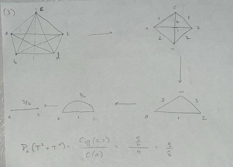

I want to find the effective conductance between points a and z using symmetry. Each edge has a unit conductance of 1. The middle are not vertex.

Yes, I forgot to mention. I understand that all the vertex except a and z are symmetrical. I do not know where to go after that

Are you familiar with the method of images in electrostatics? It creates a symmetry from a fact about a potential. You can apply that idea in reverse here.

I am actually a math guy. This question i came across was talking about the probability of reaching z before a starting from a and the formula is C_{eff}(a,z)/C(a) where C(a) is the sum of all the conductance that are neighboring to a.

Can I use the fact that in a complete graph K_n, the effective conductance between any two vertices is (n-1)c/2 where n is the number of vertices and c is the conductance of each edge

Are you sure ##\frac {(n-1)c}2## is correct?
For example, consider a complete graph with 3 vertices (A, B and C) with each edge having a conductance ##c##.
Your formula gives ##c_{\text {total, AB}} = \frac {(n-1)c}2 = \frac {(3-1)c}2 = c##.
But the conductance for edge AB alone is ##c##. The total conductance between A and B must be greater than this because there exists an additional path (ACB) between A and B.

Yes, it should be ##nc/2##. You can go directly, 1, or via any of n-2 others for 1/2 each: ##1+(n-2)/2=n/2##. The symmetry argument says there is no flow that goes via two or more others.

I feel like this would be the answer. I, initially drew an imaginiary vertical axis through c and seeing that the network is symmetrical, b and d would have the same voltages. So, I joined b and d to a point x and then added the conductance because they are parallel. By looking at the second diagram, it is again symmetrical from the a,z line due to ehcih c and x have the same voltage. The c-x line disappears because it forms a self loop at the point and since it has a potential difference 0, it doesn't influence the effective conductance. Then, I found the effective conductance between a and z using series and parallel law. Let me know if this answer is wrong please.
