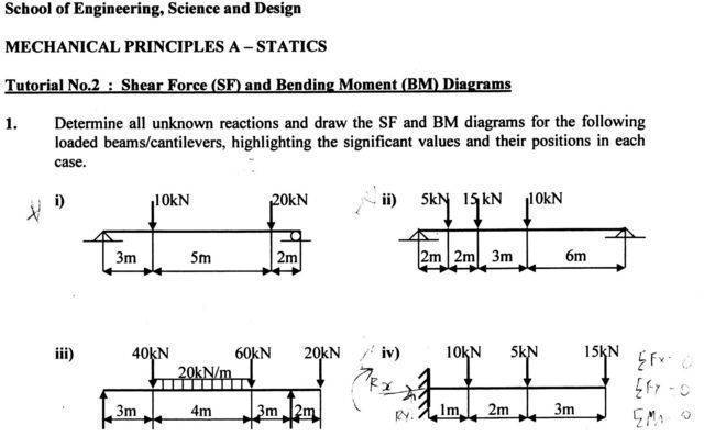

It's number 4 I'm doing

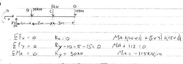

ΣmomentA= 0
ΣFx= 0
ΣFy= 0
i've got the correct answers i think, but I'm not sure how to draw the shear force and bending moment diagrams because of the moment that's included. i did draw them but it didn't seem correct because the bending moment diagram never went back to 0.
Also What is the maximum shear force and how do i work it out it doesn't say anything about it in my book?
The moment will only appear on the Bending Moment diagram, and just like a concentrated force produces a discontinuity in the shear force diagram, the moment will do the same for the bending moment diagram.
