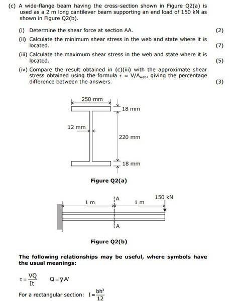

Hi,
I'm doing question (c)(ii) in the image below, full working is provided below:
(c)(i) is 150kPa.
I = bh^3/12 - 2 * bh^3/12
(0.25 * 0.256^3)/12 - (2* (0.119 * 0.22^3)/12)
= 1.3831 x 10^-4 m^4
Q = y*A
= 0.119 * 0.018 * 0.250
= 5.355 x 10^-4 m^3
shear force = (150000 * 5.355 x 10^-4)/(1.3831 x 10^-4 * 0.25)
= 2.32 MPa
I know that the solution is shear force minimum = 48.4 MPa.
Where have I gone wrong?
Thanks!
looks like you used the wrong thickness when calculating the min shear stress in the web (you used the flange width in error)
That's it, thanks.

Shear force is not measured in Pascals. It is measured in Newtons.
Q = y*A
= 5.355 x 10^-4 m^3
= 2.32 MPa
You're supposed to be calculating shear stress here.
Thanks!
