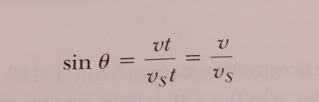

A supersonic jet traveling at Mach 3.00 at an altitude of 20,000 meters is directly over a person at a time t=0 as show in figure (see below). (a) At what time will the person encounter the the shock wave? (b) Where will the plane be when the "boom" is finally heard? (Assume the speed of sound in air is 335 m/s).
This is a two part problem (a & b) and I need help with part "a" only as I've already solved part "b" on my own so far.
Well, I solved part "b" by using sin = V/Vs with V = 1 Mach and Vs = 3 Mach to get the angle ( 19.5 degrees )
Then I used Tan = y/x solving for "x" with y=20,000 meters and Tan 19.5 degrees to get 5.66x10^4 meters.
Now for part "a" I don't have a clue how to get the time since wouldn't they just cancel out anyways by looking at the equation? I've obviously ruled out kinematics equations so...yeah.
Well, if the shock wave is generated when the plane is directly above the person, the time it will take to reach him would just be h/the speed of the shock wave, no?
Ha...I totally missed that. I used d=rt and got the time.
Thanks!
