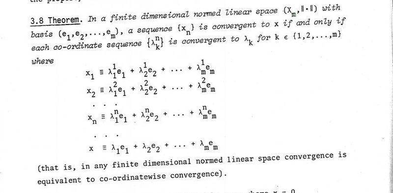

This proof from the book describes coordinate sequences as {[itex]\lambda^{n}_{k}[/itex]}.

Hopefully the attached theorem shows what is meant by coordinate convergence better than I have. However, I don't think we can use that theorem as it applies to finite dimensional space, and this problem is infinitely dimensional.
Aha, that actually makes sense. So you indeed need to prove that every column converges separately.
