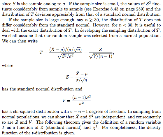

Textbook problem 8.43: Show that the variance of S squared for random samples of size n from a normal population decreases as n becomes large. Hint: First find the variance of (n-1)S^2/sigma^2.
Printed text page from a statistics textbook defining the t-statistic T as Z divided by the square root of V over n minus 1, where Z is standard normal and V is chi-squared with n minus 1 degrees of freedom.
I'm confused actually how to go about this. Sounds very simple, but when i do what they suggest, 'first, find the variance of (n-1)s2/σ2
i get larger variances rather than smaller, which makes no sense. should i be using the chart for this? (below)

Since you don't tell us what the chart represents, it is impossible to tell if it is relevant or not; I suspect not.
You are told that [itex]V = (n-1)S^2/\sigma^2[/itex] has a Chi-squared distribution with (n-1) degrees of freedom. Do you know the variance formula for the Chi-squared distribution? (It is readily available.)
