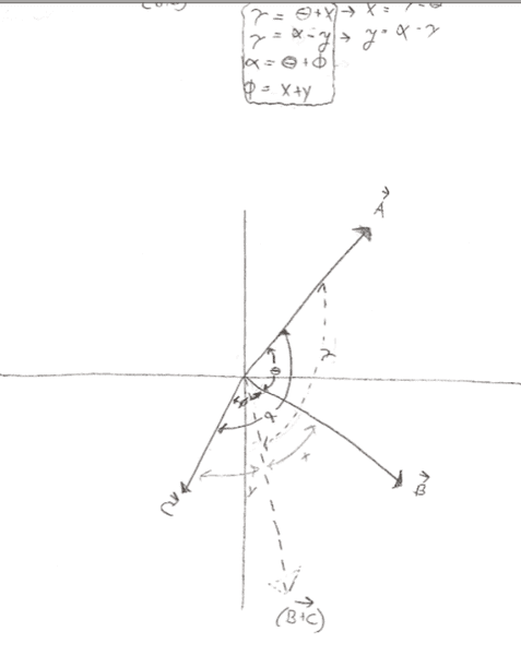

Okay then for part (a) I have started like this:
Let A B & C be 3 coplanar vectors. Let \theta be the angle between A & B; let \phi be between B & C and let \alpha be between A & C
then
\vec{A}\cdot(\vec{B}+\vec{C})=|\vec{A}||\vec{B+C}|\cos\gamma
where gamma is the angle between A and (B+C)
...now I am a little confused, i want to write that this implies
\vec{A}\cdot(\vec{B}+\vec{C})=(AB+AC)\cos\gamma
but I am not sure if that is correct. And if it is, where to go from here?
I also drew this and came up with the four relationships seen in the box. I am not sure if this helps me :smile:

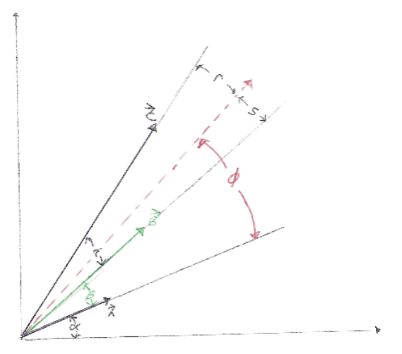

Here is my new diagram:
Now, since I already know that the dot product distributes then I know that I am shooting for
(\vec{A} + \vec{B})\cdot\vec{C}=\vec{A}\cdot\vec{B}+\vec{ B}\cdot\vec{C}
So the end result should be
something=|A||B|\cos\beta+|B||C|\cos\gamma
From my diagram I have
(\vec{A} + \vec{B})\cdot\vec{C}=|A||B+C|\cos\phi
This leads me to believe that I must write \phi in terms of \beta and \gammaFrom my diagram, I also have the relationships:
\phi=\beta+s
\phi=(\beta+\gamma)-r
Beta and gamma are 'known' and r, s, and phi are unknown...
Seems like I am one equation short of doing something. :smile:
Any ideas?

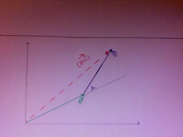

Hint: |\vec{B}+\vec{C}|=___?
I don't know without using components :confused:
Try drawing the tail of the vector C at the head of the vector B and draw in the vector B+C. Draw all the angles in and use the law of cosines.
If I do it this way, I think that I will need to go back to defining the angle wrt a datum instead of from vector to vector... other wise, i do not know what angles to write in.
Extend a dotted line along the direction of B and label \gamma the same way as before...you should quickly see that one of the angles in your triangle is \pi-\gamma:wink:
Hmmm. I don't see how an angle inside my triangle is pi-gamma.
Maybe I'm cooked ...
What if I drop a perpendicular from the tip of C to my extension of B.. then wouldn't the angle between B+C and C just be gamma?
Basic Trig...look at the large angle adjacent to gamma...if gamma were zero you would simply have a straight line (pointing in the direction of B) and that angle would be 180 degrees or pi radians, in general that angle is (180 deg- gamma)
No, because B+C is not parallel to B
Oh man :blushing: When I read your post, you said pi - gamma, but I was thinking pi/2 - gamma...pi = 180 ... my brain = pudding
