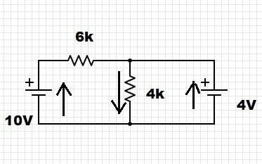

KCL and KVL
The sum of the currents at the top node equals the current out through the middle
(Call ##I_1## the current from the left and ##I_2## the right)
##I_3 = I_1+I_2##
And the sum of the voltages around the loops equals 0.
##-I_3(4k)-I_1(6k) + 10V = 0##
##-I_3(4k) + 4V = 0##
The system of equations yields solutions
##I_3 = 1mA##
##I_1 = 1mA##
##I_2 = 0##
Now, it appears that either I made a mistake, or there is zero current going through the source on the right. Is it logical to conclude that the source on the right is irrelevant to the circuit?
No mistake. Well, irrelevant to the circuit as drawn, yes; if other components were added it would likely come into play.
Could I have predicted this from the start, and crossed off the right side source, and solved for just a single source with series resistors?

That's difficult to say.
You might have noticed that removing the right side source & leaving that branch open would give a simple series circuit with the voltage across the 4kΩ resistor being 4 Volts.
That's not something one would normally look for.
