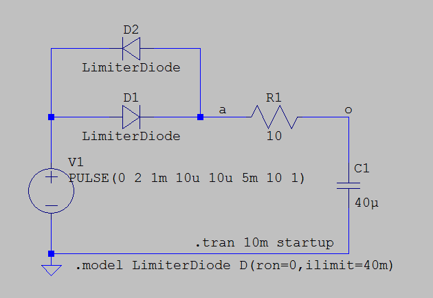

Ok, so here's what I dreamed up...
In the first, a current-controlled voltage source (an "H" source) is tied to a typical small-resistance current sensor. This one can be adjusted in various ways by messing around with the various parameters, for instance, to get a "soft" current limit.
In the second, you get a hard current limit from an ideal current source, and a hard voltage limit from an ideal zener
The trick is very simple and effective, adding an ideal diode to any voltage source with the Ilimit parameter set (along with Ron=0 for perfect ideal behavior) will limit the current sourced to the specified value.
To also limit the current sink add another diode in parallel but reversed.
The diode model takes care of smoothing the discontinuity when switching between regions so that the simulation converges properly.

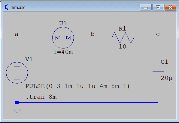

I have added a symbol and corresponding sub-circuit so that the current limiter device ilim can be selected from the components list and configured through the right click menu.
Rename file ilim_asy.txt to ilim.asy and ilim_cir.txt to ilim.cir and drop in the directory where you store your local components (or the LTspice library dir) and make sure that directory can be selected from within the component window.

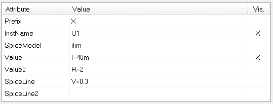

After adding the component, in the right click configuration pane along with the current limit, optional series resistance and fixed voltage drop can be also specified (just added some random V and R numbers here, R and V are zero for the plot showed below).
I use these for instance to model AVR microntroller pins which are current limited at 40mA and with approximately 30Ω of (MOSFET) Ron.

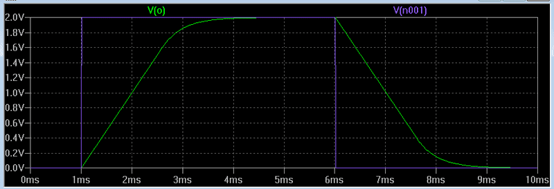

The plot below shows the current limit in both directions in explicit action ...
