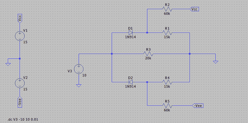

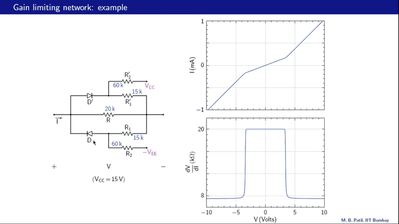

This is one more thread in my quest to learn simulations in LTspice. I am trying to simulate the gain limiter network shown in this video. A snapshot of the video is available for quick reference:
Two-panel plot from a gain limiting network lecture: top panel shows I (mA) against V (Volts) rising with a kink near 0 V; bottom panel shows dV/dI (kΩ) against V, flat near 8 kΩ with a plateau at 20 kΩ between about -3.5 V and 3.5 V.
My schematic in LTspice is shown below:
LTspice schematic of a gain limiter with V1 and V2 supplies (15 V), Vcc and -Vee rails, V3 sweep source (10), diodes D1 and D2 (1N914), resistors R1 and R4 (15k), R2 and R5 (60k), R3 (20k), and directive .dc V3 -10 10 0.01.

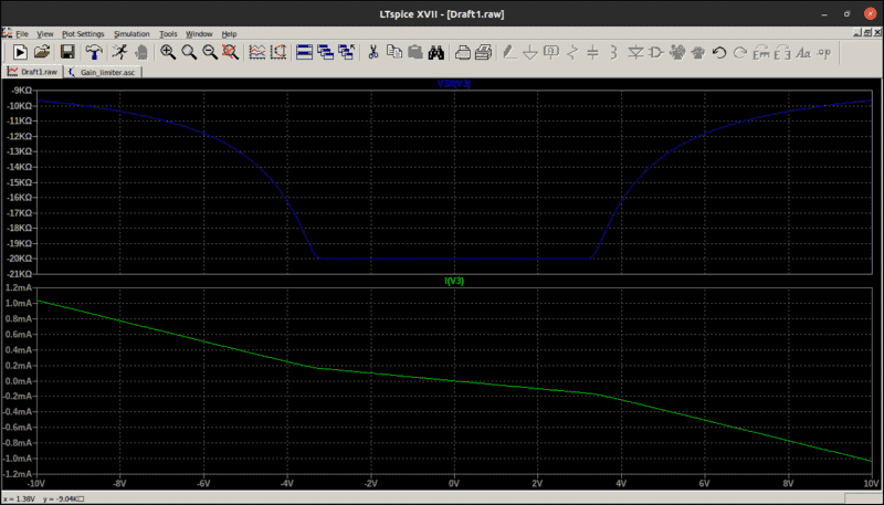

For the simulation, I am using DC sweep on voltage source V3, starting from -10 V to 10 V, incrementing by 0.01 V. Regarding the diode, I have picked the first one available in the library of LTspice. I am plotting the current through V3 vs the voltage of V3, and the ratio V3/I(V3) vs V3. The results are shown below:
LTspice plot of V(V3) in kΩ from -10V to 10V (top, blue) and I(V3) in mA (bottom, green); V(V3) drops to about -20kΩ between roughly -3V and 3V, while I(V3) falls steadily from 1.2mA to -1.2mA.
As you can see, my graphs are almost identical to those in the video, except that they are flipped. Actually, the current in my circuit is flowing in the opposite direction to what has been shown in the video.
What is the error that I am making?
The LTspice files are attached; please remove the .txt extension before loading them in the software.
The positive current direction in the first picture is in the opposite of the positive current direction in the LTSpice simulation. In order to see the direction of positive current in the simulation, hover the mouse over V3 and you will see a symbol with an arrow, which points down (at least when I run your .asc file).

Yes, I know, and that's what I wrote — in my simulation, the current is flowing in the opposite direction to what is shown in the video. I can easily plot the negative of the current and dV/dI and get the required plot, but that is not what has been done in the video. I need to find the error in the simulation.
The spice current direction and polarity of voltage sources makes it difficult sometimes. The easiest way here is to use a current sense resistor, then plot "V3/I(Rsense)". If you need to reverse the sign of the current then "end for end" Rsense on the schematic. Alternatively insert a unary - in the plot equation; -V3/I(V3); to invert the plot.

Thanks a lot; sensing the current through Rsense instead of V3 solves all the problems. But this was a bit weird.

If I disconnect the Rsense in your file, rotate it by 180°, and reconnect it, the direction of current changes! How is this possible?
There is a spice convention that current always flows into "pin one" of a component. That current in the component will be reversed if you turn the component around, but the current actually flows the same way in the circuit wires between the nodes. LTspice can't measure the current in a wire, only the current in a terminal. You can always edit the plot equation with a unary minus to fix the sign.
