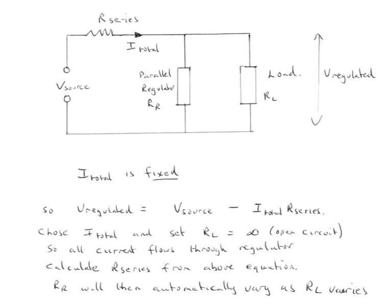

Firstly, yes you could use the diode as the basis for a simple regulator.
This type is known as a shunt regulator.
It is called this because it is in parallel with the load. It works in conjunction with the load to draw a constant total current from the source. If the load varies the shunt regulator varies its own draw to compensate.
As JN noted you have to draw this current through a resistor from the source.
This is a series resistor, not a parallel one.
The diode may be used in forward voltage mode like this and indeed is used this way for this purpose within some integrated circuits.
However you can only get 0.6 volts this way.
If you reverse the diode and use it in zener mode then a wider range of stabilised voltages are available and, of course, the zener diode is designed and optimised for this purpose.
(All diodes have a reverse breakdown voltage that 'could' be used this way, just as you 'could' use a zener in the forward mode. But both such operations would be sub optimal).
There are, however simple better ways to implement shunt regulators using transistors.

Yea i get it, that's what i wanted to know. The possibility. I know Zener is mainly designed for this. But can you explain why you need to put a series resistor along with a parallel one?
And wouldn't my resistor on the parallel side be on 0,6 volts? Thats the main point, to maintain constant voltage drop, only current varies?
It's all in the attachment.
I said and repeat you do not want a parallel resistor.
(You can have a parallel resistor as a load, but it then has nothing to do wit the regulation)

A resistor in series with the diode.
Remember Kirchoff's voltage law: The algebraic sum of all voltages in a circuit must be 0V.
If your source is something like 5V, and you want to use a diode to regulate it down to 0.6V, whee does the 4.4V left go? It can't just disappear, it has to be accounted for somewhere.
That's where the series resistor comes in. The current through the resistor dissipates that 4.4V as heat, and leaves 0.6V for the diode.

No the zener does not affect the ripple.
Regulation by zener can only affect variations in the load. It does not affect variations in the supply - which is what ripple is.
C4 is there to remove as much of the ripple as practicable. It charges to the peak value of the AC supply from the bridge and supplies current to the load when the instantaneous value of the AC supply is below this peak. I see it is a reasonable value 1mF for this purpose.
The purpose of R8 is to provide a (light) load for the power supply when there is no other load connected. Normally we would expect to see a much lower value of load than 10k.
In a nutshell, will I have constant current AND voltage through load?
Of course not, unless the load is constant.
The earlier stuff I gave you said that the total current taken by both the zener and the load is constant.
As the load changes its resistance so the zener changes its current draw to maintain this total.
Oh and you have a voltage across the load, not through it.
