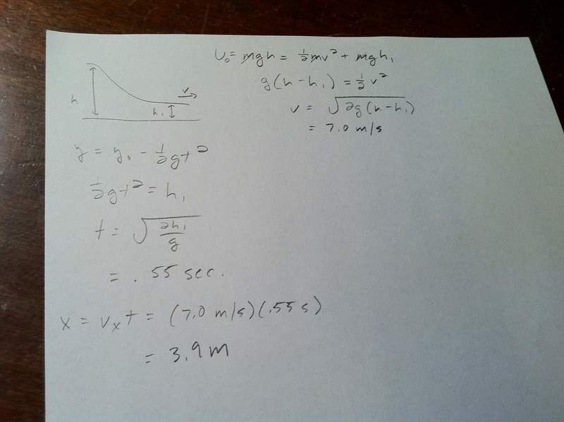

I'm not seeing my mistake, but I'm not getting the answer in the back of the book.
A water slide has a height of 4.0 m. The people coming down the slide shoot out horizontally at the bottom, which is a distance of 1.5 m above the surface of the water in the pool. If a person starts down the slide from rest, neglecting frictional losses, how far from a point directly below the bottom of the slide does the person land?
Just conservation of mechanical energy, and kinematics.
The book gives 4.9 m, but here is my work where I get 3.9 m. I almost hate to ask what I'm doing wrong...
  • Handwritten solution on paper: sketch of a slide dropping from height h to a lower level h1 with exit velocity v, energy equation mgh = 1/2 mv^2 + mgh1 giving v = 7.0 m/s, then t = 0.55 s and x = v t = 3.9 m.
Recheck your calculation for the initial velocity. What's the change in height from the top of the slide to the bottom of the slide?
Oh - would the 4.0 m be the distance from the top of the water slide to the pool, or the distance from the top of the water slide to the bottom?
