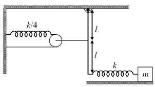

In the given figure, all the springs and pulley are ideal and surface is frictionless. The rod is massless. The time period of horizontal oscillations of the block is?
I used two different approaches and both give different and wrong answers-
Consider a very small rotation of the rod by an angle θ. Let x be the displacement of the mass m.
1) Torque-
Trestoring = -(k/4*2*(lθ)*l + k(2lθ)*2l)
Simplfiying and writing L.H.S as 4ml2α
α = -9k/8m*θ
ω2 = 9k/8m
2) Force-
Frestoring = -(k*2lθ + k/4*2*lθ) = -5klθ/2 = -5kx/4
a=-5kx/4m
ω2 = 5k/4m
Can someone point out any mistake above and show me the correct method?

Hi Abdul! :smile:
You need to treat x as independent of θ. :wink:
(and I think your Trestoring = -(k/4*2*(lθ)*l + k(2lθ)*2l) has too many 2s)
x and θ are dependent. How can they be independent of each other?
Which '2' do you think is redundant?
The mass m is not fixed, so x and θ can vary independently. :wink:
ok...so the force due the lower spring is k(2lθ+/-x) ?
How do I decide whether it is + or - ?
I don't really understand your question :confsued: …
you decide which way x goes, and which way θ goes.
I got the answer. Thank you!
