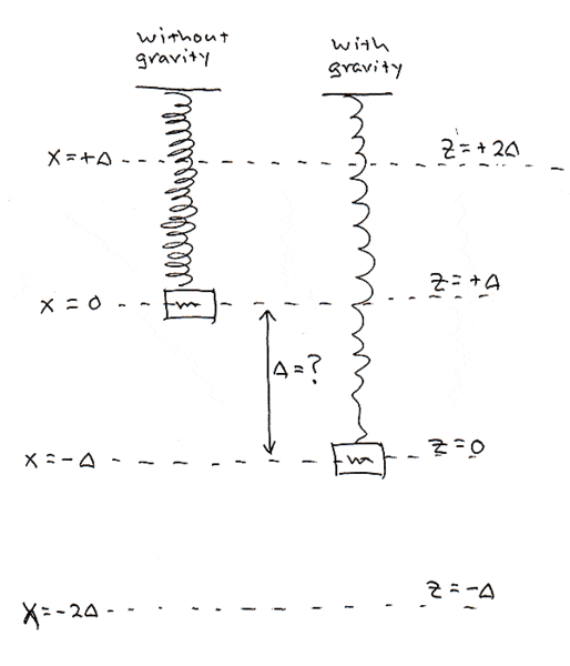

First suppose there is no gravity, and we have the spring oriented vertically with one end fixed. Let x = 0 be the position of the mass when it is in equilibrium. Then
$$U_{spring} = \frac{1}{2}kx^2$$
Next, remove the spring for a moment, and "turn on" gravity. Define the gravitational potential energy such that it is zero when the mass is at the same x = 0 position as defined above. Then
$$U_{grav} = mgx$$
Under the influence of both the spring and gravity, we therefore have
$$U = \frac{1}{2}kx^2 + mgx$$
In this situation the mass has a new equilibrium position, where ##\vec F_{spring} + \vec F_{grav} = 0##.
Exercise 1: Find the new equilibrium position... how far is it below the old equilibrium position?
Exercise 2: Define a new vertical position variable, z, such that z = 0 at the new equilibrium position. Find an equation that relates z and x.
Exercise 3: Change the variable in the equation for U above, from x to z, by making an appropriate substitution. What do you get?
The point is that when you dangle the mass under its own weight, the equilibrium position moves from the point determined by the rest length of the spring (call it x = 0) to some new lower position (x = c < 0) where F = -kc = -mg. That is, the new rest position is exactly where the stretched spring exerts a restoring force that exactly opposes gravity.

I got lost at Ex 2, can you please give me more hints?
Here's a diagram which might help. I don't know what you got for Ex 1, so I'm calling it Δ. For any vertical position, what is the relationship between z and x?
