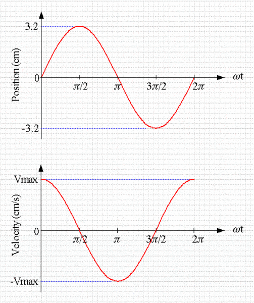

Here's a diagram that may help to think about the problem:

I finally got it right... t = 0.357s
It is just the period time in half! I might still be missing a point though;
It seems though that the equation didn't help much at all.
I had NO IDEA why you guys were trying to set the position to x=0 in the equation for it, you just could have said sooner
t = 0.357 when x = 0 because it is half of the period when x = 0 AGAIN. Thanks.

Next time draw a diagram before you do any calculations. Something like the one gneill posted. Or make it plot out by wolframalpha.
