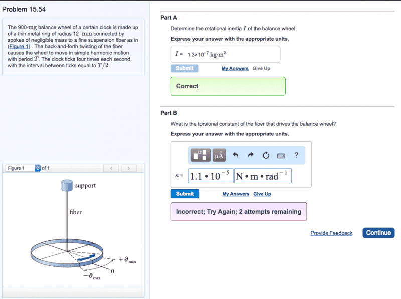

The 900-mg balance wheel of a certain clock is made up of a thin metal ring of radius 12 mm connected by spokes of negligible mass to a fine suspension fiber as in (Figure 1) . The back-and-forth twisting of the fiber causes the wheel to move in simple harmonic motion with period T. The clock ticks four times each second, with the interval between ticks equal to T/2.
I am not so sure how to approach this.
I tried to find T. Since each seconds has four ticks and the time span between two is T/2, thus I inferred that 1 second = 3T/2 or T = 2/3 Second.
I know the formula for find K is T = 2*pi*sqrt (I/K), but I kept getting the wrong answer. Please help me out.

I followed your guide and this is now I interpreted.
One interval Δt is equal to T/2. Then four of those are equal to 2T which is equal to 1 second. Then 1 T = 0.5 second.
With the correct answer to I = 1.3 * 10^-7 kg.m^2, and by applying the formula T = 2*pi*sqrt (I/K), I still get the wrong answer. This is getting tricky.

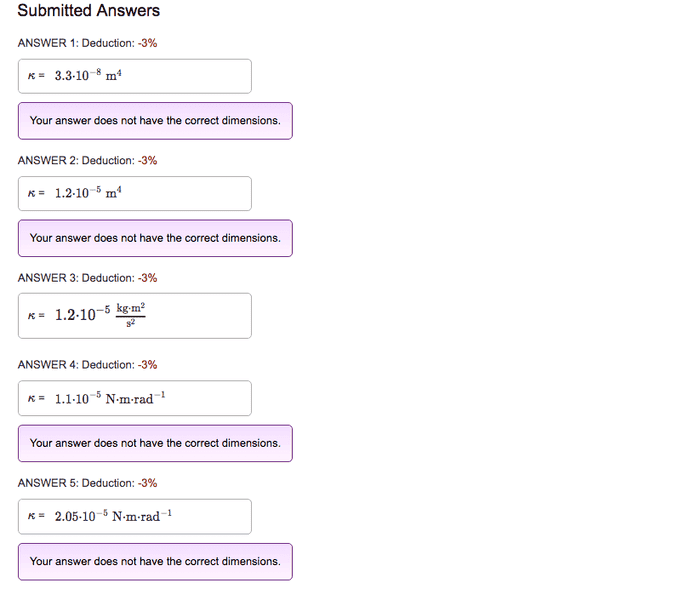

What units did you enter? kg m2/ s2 or Nm/rad. To me, these are essentially the same.
The second one along with our answer of K, it said incorrect dimension.
I don't see why that's considered incorrect. I agree that online homework can sometimes be annoying.

Here is the screenshot. So upsetting.
