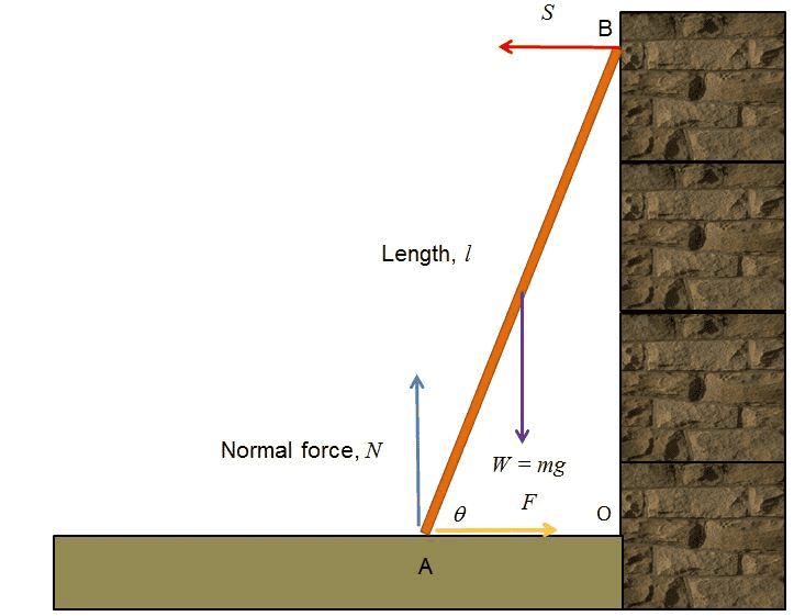

A ladder of mass 20 kg and 3.0 m in length is propped up against a wall at an angle of 72o.
Calculate the support force on the wall.
Which data item is irrelevant?
g = 9.81 N kg-1.
f*d= moment
I know the answer and how to go about it the normal way. Could i possibly use the nose to tail method of finding the S value. Although it does not say in the question there are three forces on ladder support force , weight, support form the wall. So could i make a triangle then use sine rule cause i think that is so much easier. I used method and got s/sin(18) = 20 g/sin(72) and i got s as 63 the answer is 31

the support force from the ground against the ladder. imagine the ladder leaning against the wall. The direction of that one since its in equilibrium would be 72 degrees to the horizontal cause mg acts straight down. support force from the wall is to the left.

No mate. I understand the normal way of going about it, i was asking if you can use the " nose to tail method" of finding the S value or is that not a method i can use? i find that way easier so i was asking. I got an answer which is twice as big as the actual answer. Is the method wrong or the way i did it incorrect?the way i did it:
243016
You can see an upside down triangle, this is just an image to make it easier to understand how i got my answer. Question does not mention frictional force. The upside down triangle has an angle on the bottom side theta 72, so using the Z angle at point B it also has 72, so i can use soh cah toa to get the top of the triangle the S force acting against the ladder from the wall. I get an answer which is twice as big what did i do wrong?

i made a triangle ... if you read my previous reply friendo
using soh cah toa1) Mg / S = tan(72)
Mg/ tan (72) = S
M = 20 g = 9.8
S= 63
answer is 31
Your equation assumes (incorrectly) that the force at A is directed parallel to the ladder. Now that you've tried the "guessing" method, let's see your force- and moment balance equations.

You say you assumed the resultant of the two forces from the ground is along the line of the ladder. If that is the case, what do you notice if you take moments about either B or the middle of the ladder?

There's a handy rule: if three forces on a body are in equilibrium then their lines of action must pass through a common point.
