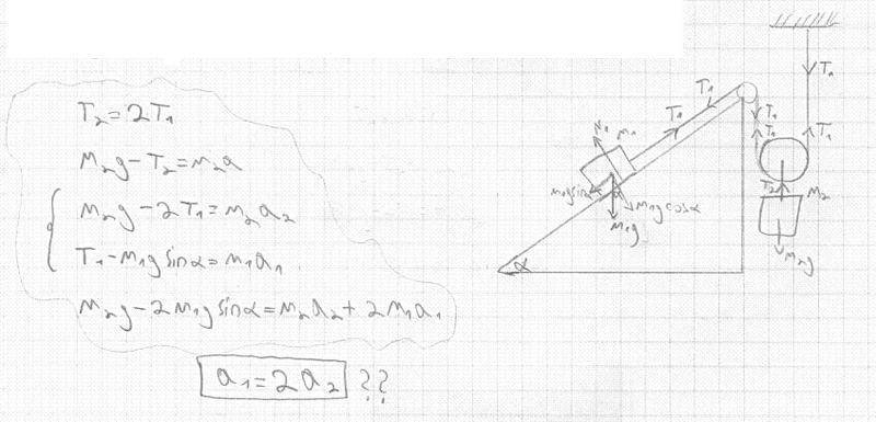

Hey guys.
I have the following pulley system (in the pic).
I wrote down all the equations.
The thing I don't get is the accelerations equation (a1 = 2*a2). I understand that I can get to this equation somehow by the length of the rope, but how?
Thanks.
Hi asi123! :smile:
You get it by double-differentiating x1 = 2x2
and that is simple geometry … when m2 moves a distance x2, m1 moves a distance x1 = 2x2. :smile:
