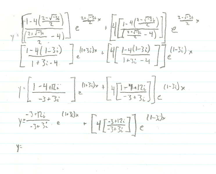

I'm trying to see if what I have before the e match up with the correct answer.
the correct answer is (2+.5i)e^(1+3i)x + (2-.5i)e^(1-3i)x
This is what I have so far.
I don't know how I would simplify anymore. Please help.
I noticed that you rewrote sqr(-36) = 3i when it should be 6i perhaps this is where you went wrong.
If you look and then divided it by 2 making it equal 3i
sorry, didnt notice the 2 divisor.
wrt simplifying, how about using the complex conjugate of -3+3i to multiply top and bottom that would eliminate the complex number denominator.
Also there's eulers formula so you could convert the complex factors to e to some power and then combine the powers and simplfy further.
Ok. thanks for the help. I'll try again.
