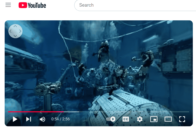

I assume you mean you want a water tank that would provide (1) neutral buoyancy and (2) the same resistance to motion as low air pressure at 16,000 to 18,000 feet altitude.
If that is indeed what you are looking for, then the concept is clear and the physics is nonsensical.

In a nutshell, the 16000-18000 feet altitude or at least a simulated altitude of similar level in an altitude chamber is much preferred than the other alternative which is training underwater even with a breathing hose.
Unless you're training to be an astronaut... :smile:
