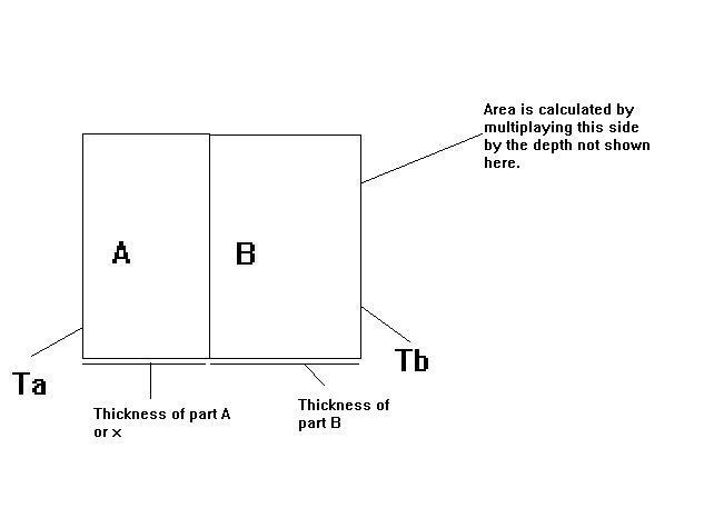

This is not homework, so I think this is the right forum. I am trying to write a program that simulates the heat transfer between, say two cubes of different volumes, heat capacities and thermal resistances.
I know Newton's law of cooling just works dandy for say an object cooling in a fixed environment. My questions include: how does this extend to two bodies exchanging heat between boundaries of different thermal resistances?
Are the objects separated i.e. is there an air or vacuum layer between them?
Claude.
Well since u going to write a program about it i will assume there's nothing in betweent the bodies and they are directly connected, so the driving force is conduction heat transfer. Assuming that A and B have thermal conductivity of ka and kb respectively. Ta and Tb are wall temperatures at each extremity. Total heat flow Q= (Tb-Ta)/(Ra+Rb)
Ra= Thickness of transport area/(ka*Cross sectional area).
Check the pic
